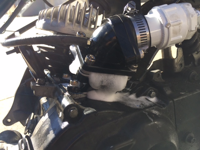

Hey everyone! So first off the build:
24mm polini carb with 112 main 38 pilot (brand new)
Naraku black manifold (brand new)
PG short exhaust
8.44:1 gears
Just can't seem to figure out why my scooter isn't starting. I built this scooter a while ago and it ran well for a couple months and then it all of a sudden decided it didn't want to start up anymore. I know scooters need spark, fuel and compression in order to run so I went and did some checks. First off I did a compression test and compression is at 120 psi with throttle wide open. Then I did a visual check for spark and I can see a spark coming out of the spark plug when I ground it to the engine case. Finally I went and checked for fuel. Carb fills with gas when I kick it over and I also tried choking the carb with my hand to start it up and my hand gets wet with gasoline so I know I have fuel. So we have fuel spark and compression but it still won't start up. Trouble starting can be caused by an airleak so I went and built myself a leak down tester. Pumped it to 7 psi and sprayed it down with some soapy water. No bubbles around the base gasket or head gasket areas. The only bubbles I saw were on the Naraku intake which is a bit sad for me since I bought it to replace the CT manifold and hopefully not worry about it leaking. Pics below. Also put on a fresh exhaust gasket and added some high temp hondabond. I am lost and any help is much appreciated!
PG short exhaust
8.44:1 gears
- Naraku leaking

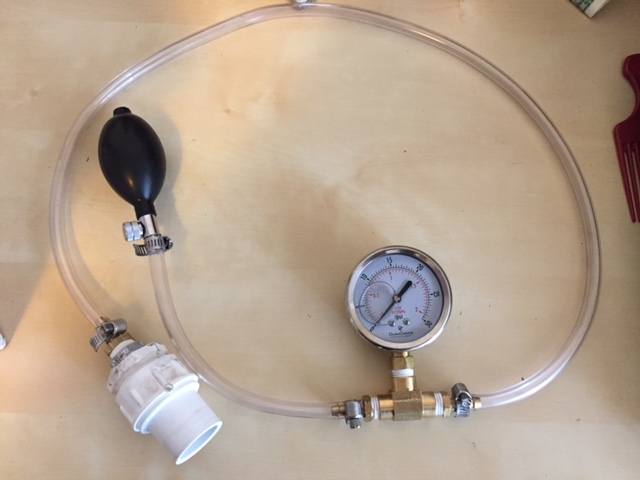

- Leak down tester

Compression tester or the leak down tester? (The picture is the leak down tester that I made) Compression tester I got from oreilleys for like $25-30 I think, was a while ago. I was originally using a BR8HIX plug but I didn't have any more lying around and I had some BR9s left over so I threw that a fresh one in and it still didn't want to start up.MrJumps wrote:Have you trid to see if the spark is consistent? It may spark then miss for a few sparks then spark again. Maybe go lower idle jet?

I remember reading that you should use 6-7 psi when doing the leak down test. Checked both crank seals after I did the test to make sure I had everything in place and all seems to be well. Naraku gasket is in place. As far as flywheel I didn't do anything besides take it off to split the case and then put it back on when I put the cases back together. Really confused why my bike won't start.graphite9 wrote:pretty sure 7 is too high. I seem to recall 3-5psi. You will blow out seals, and gaskets. I've never seen a naraku leak, but the pressue has to go somewhere at that psi. I just read to not go over 6, and most reccomend under 5

Leakdown tester was about $25 I think. $15 for the pressure gauge and $10 for the various other stuff like the hose, clamps, teflon tape and the t connector.MrJumps wrote:I was talking about how much to make the leak down tester.

After I did the leak down test I went through and checked both seals, both still in place. The air held pretty well but i could definitely see air bubbles coming from the naraku in the picture.graphite9 wrote:to my understanding its not about how much pressure it holds, its how long it holds it over a matter of time. so it doesnt need to be high. after 7psi i would go back through and make sure your seals are all in place and correct

Check to be sure your reed cage is sealed. If it's leaking that bad you need to check why. Naraku don't leak like that unless it's not tight enough. Check the torque and tighter it as you check for leaks.
It won't start if there's a leak at the cage and if it does start it will die.

If the engine is flooded wouldn't the spark plug be wet every time I remove it? What else can I do to check if the engine is flooded and also how can I unflood it if it is flooded? I did notice a long time ago that I would sometimes see gas leaking onto my left engine side right around where the clutch is which was coming from the carb. And now that I'm reading more about engine flooding I'm thinking maybe it is flooded. Because a couple of times when the scooter was running it died randomly and wouldn't start for a while which eventually led to it never starting again. I don't think it was a seize because I always had a temp gauge on and temperatures never broke 350. And through some posts here I see that flooding can cause scooters to randomly die and have trouble starting up again
Will retighten the naraku bolts to make sure that wasn't the reason for it leaking, hopefully it is though. Even so the leak from the naraku is so tiny that it should still be able to start.
