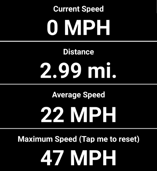

Decided to get a GPS app to see what my top end actually is since I can't tell on the speedometer. Is this pretty good for the stuff I've done to my elite?

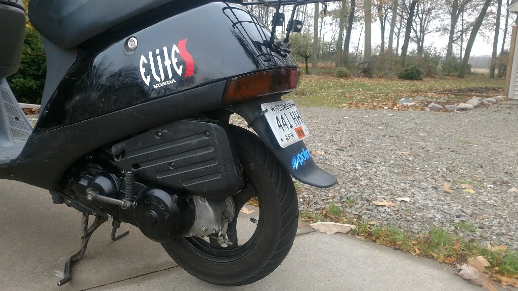

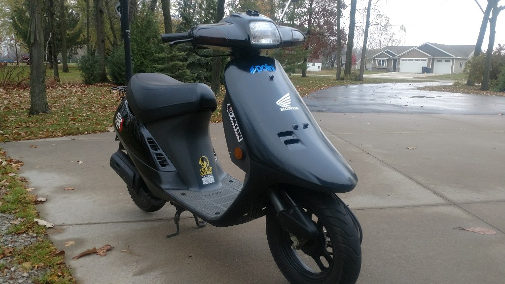

Big thanks to bfowler for the tail light and turn signal lenses!
