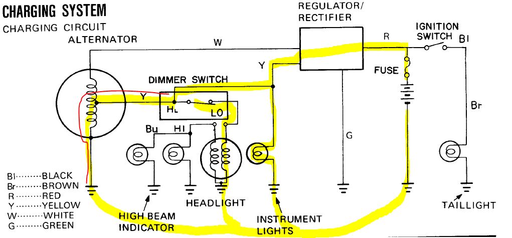

1) Jumpering Battery voltage to the headlight creates an electrical fault, with a high current path through the Stator coil. That change should be removed.
2) The fuse will protect the wires from melting, double check the correct size fuse was installed. Should be 7 amp for a Spree.
The wire gauge of the Green wire ground and Red wire is about 16 and will not melt if 7A is drawn.
-- Wire diagram markup

Didn't jump it for the headlight. It comes on anytime it's running regardless if the key is on. It's jumped at the ignition to send power to everything else besides the headlight (electric start, horn, tail/brake lights, turn signals, etc...). What's odd is it was already like that all I did was put a switch in the middle of the jumper wire so it wouldn't drain the battery. (before when it had a kick start it didn't matter because the battery wouldn't hold a charge and could still start it) So I'm confused as to why now all of a sudden the wires melted and even more so why the fuse didn't blow. It was bigger than a 7amp fuse (not sure what size because it's melted now) but I would think it would blow either way if it got hot enough to melt the whole fuse and wire all the way down the harness down under the floorboard as well as the ground wire for the battery. I don't think it has anything to do with jumping the switch because it does the same thing as turning the key would so I'm just trying to figure out whats going on with it. I'm going to have to replace the harness and don't want it to happen again...
