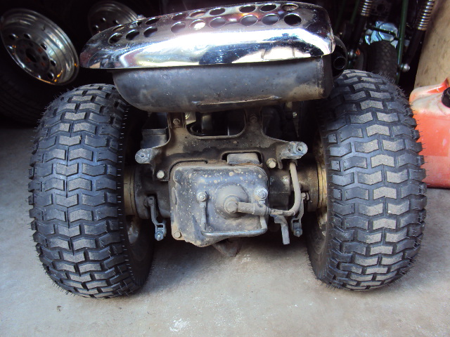

As for Gyro tires, the OEM size of 4.50 X 6 have been discontinued for a long time.
Some Gyro owners are buying the 5.30 x 4.50 x 6 Carlisle Sawtooth as replacements.
Other makers exist in that size, you will just have to shop around.
Personally, I buy 15.00 x 6.00 x 6 lawn tractor front tires with chevron tread for street/lawn use.
Since I have NO rear fender assembly on my Gyro, clearance is not a factor.
I THINK member SIX66 was running 13.50 x 5.00 x 6 chevron tread WITH rear fender and no rubbing.
My opinion is that the size I am running is far superior to the OEM size for both braking and cornering grip.
Also seeing some slight increase in top speed.
When I was racing on asphalt, my tread choice was a straight rib design, almost slicks actually..but they are lousy for wear.
Member kevinv710 is building a TG50M Gyro S currently, and has been faced with the same dilemma about tires as you.
Might reach out to him for some more input.
Here's a pic of my most recent set of tires...good luck with all...mm...
