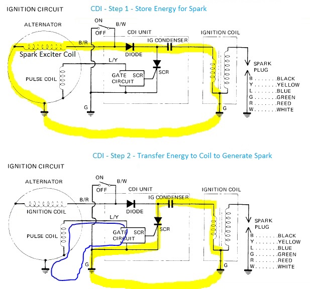

I have had the stator coil Honda calls the Alternator Exciter coil go bad on a couple scooters. For problems the bad coils caused - no spark on one scooter. The others ran for a few miles, then no spark until the engine was dead cold - an hour or more.
In my experience, the coil can be bad even if it passes the resistance test. A shorted turn does not always cause a 'too low' reading.
I know nothing about the aftermarket CDI and it's flashing LED. Might be worth verifying the CDI functions on a working scooter before getting a stator.

The grounds are in the drawing member @mousewheels has kindly posted above, represented by the 3 horizontal stacked lines. Note there are 6 ground points shown in the drawing. The wire colors are also noted...the wires must be traced to their grounding points. It is vital they are clean and tight and actually *grounded*.

Yes, the spark exciter is *the* source of energy to drive the coil. It charges the capacitor inside the CDI to around 300v DC. The timing of spark is controlled by the pulse trigger coil. The pulse trigger coil is a timing signal only, it in itself cannot supply the energy required for a spark.mousewheels, you are saying that the stator/exciter coil being bad can cause a no spark condition? I was really hoping it couldn't since it is not a cheap part. Are there no aftermarket coils that would work? I see a lot of cheap stators for other bikes, just not for the spree.)

I think that was a design choice. The ground is shared with the another circuit and doubling the wires provides a splice point.Also, the Green wire from the ignition coil is actually 2 green wires. What is the reason for this? Why would it need more than 1 ground wire

the wire diagram has 6 grounds, but that doesn't mean 6 chassis grounds does it? Because I can only find one which is solid and good. The others join in somewhere on the wire harness right?
Re: spark related questions
you've got to "read between the lines" too....for example...the spark plug body actually supplies the grounding point to engine (via the threads to head). Some of the coil components may also ground at their mounting points.
Using your multi meter will simplify determining ground integrity, in the meantime you've got to trace each wire or component pictured in the schematic and determine each point. The schematic does not lie. Oh, no.
