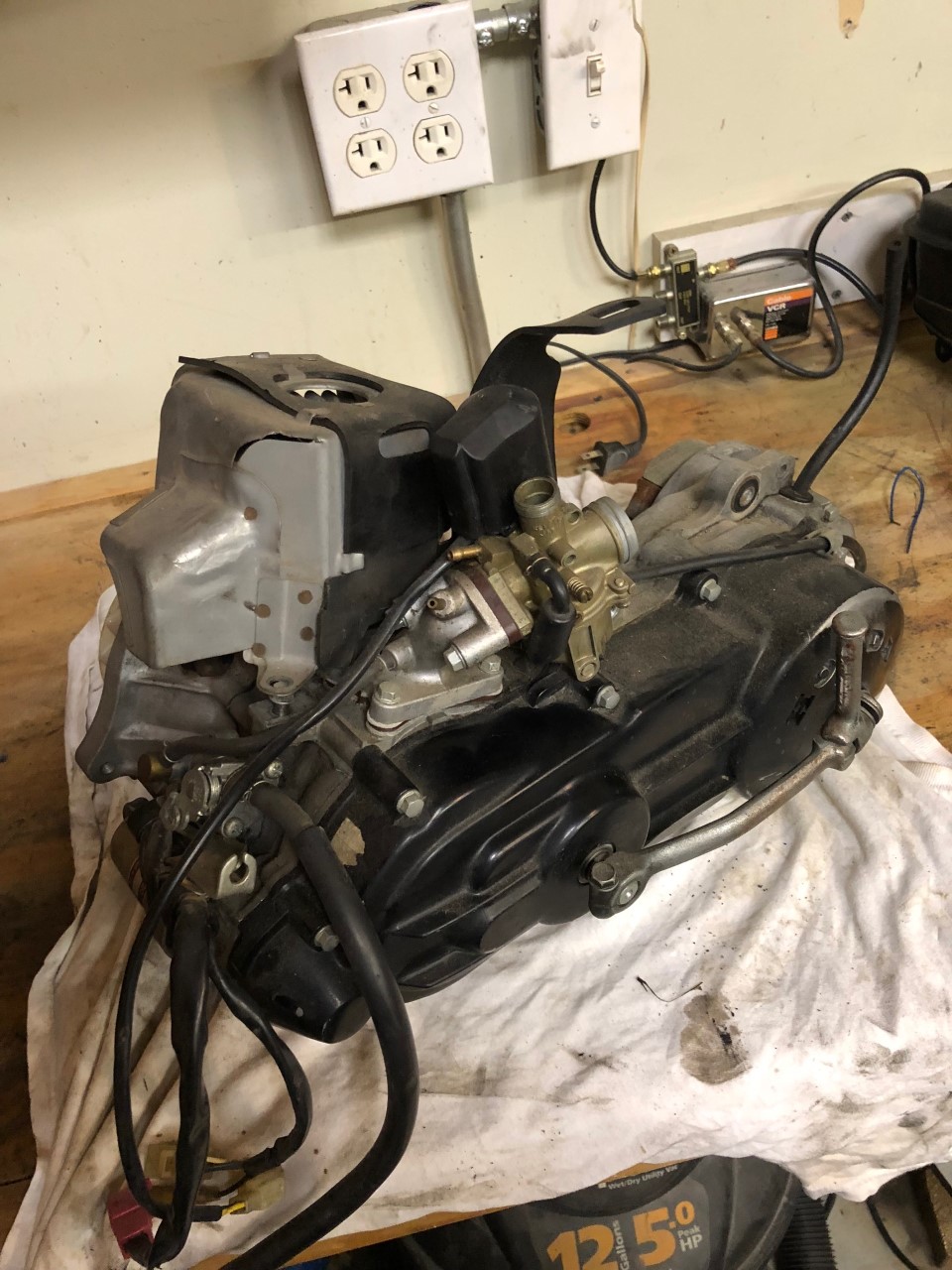

Here's mine. Easiest swap ever haha. 87 aero 50 motor
I just ripped the motor back down on this one, I'm going to do a ported airsal BBK with a jasil racing crank along with a 24 mm pwk carb and some kind of pipe, not sure which one though. Maybe A proma bad snake or Homoet.
