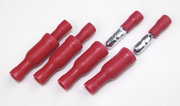

Re: Just need some general help
Not sure on gauge. Just match the gauge of rear lights. Soldering is nice but future removal requires cutting/re-soldering every time. Use bullet butt connectors. Be sure to to get the correct size for the chosen wire gauge. Too many times Ive seen connectors used intended for much larger wire gauge.
- EC26E7D9-B07F-4953-872B-00A0FC67EDAA.jpeg (70.51 KiB) Viewed 18746 times
Thank you, I'll have to take a trip to my local hardware store and do some research. I was thinking of buying a parts spree for the random bits I am missing, but seeing how much these get changed around and "modded", that's not going to be very practical.Meatball wrote:Not sure on gauge. Just match the gauge of rear lights. Soldering is nice but future removal requires cutting/re-soldering every time. Use bullet butt connectors. Be sure to to get the correct size for the chosen wire gauge. Too many times Ive seen connectors used intended for much larger wire gauge.
