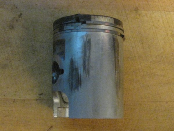

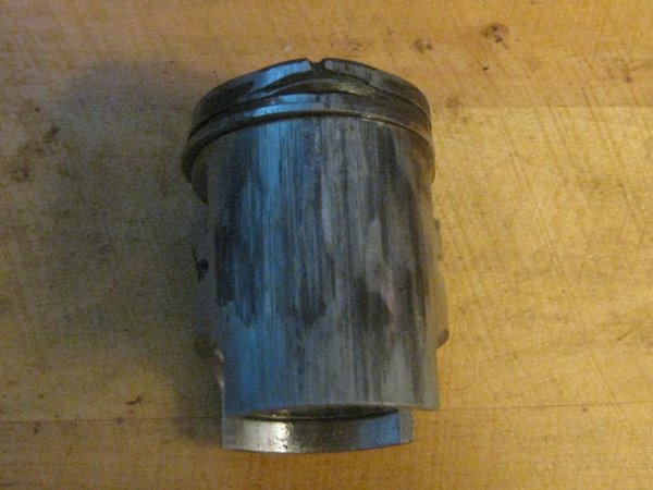

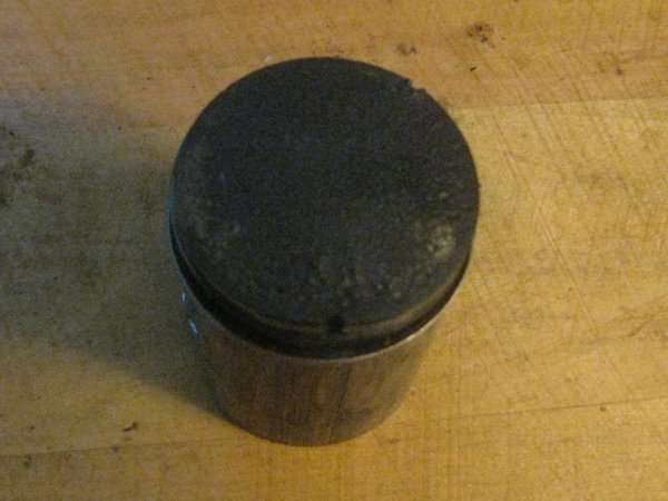

The 2000 soft seized last week.. a combination of a long WOT run in the Florida heat, regular gas, and, IMHO the removal of the tab in the air cleaner cover. Three days ago, I installed one of these:
https://www.ebay.com/itm/Cylinder-39mm- ... m570.l1313
It is a very high quality and complete kit and is a very good deal with superfast shipping. This time, before running the engine after intalling the kit, I glued the tab back into the air cleaner housing cover. The scooter is much quieter now, and runs pretty much the same as the 1996. I am in the middle of the break-in period, but I am willing to bet that the top speed is still 31 mph.
Now when you look at the piston, the first response will be, "you must have an air leak somewhere.. too lean, too hot". Yes, there was a massive air leak.. i.e. the removal of the tab in the air cleaner housing cover.
Both the SR and the S have exactly the same air cleaner housing covers, and yet the SR goes 36 mph. Bottom line is that I think it is bad advice to remove the tab, and I don't plan on doing it again. I have no idea where this suggestion originally came from and what was the thinking of doing it, since the SR doesn't have the tab removed.
I won't know for sure if reinstalling the tab solves the problem, until this engine either soft seizes again, or I have a couple of years of good performance. I'm also going to run only premium gasoline from here on, so I realize that might skew the results. I'll report back when I have the answer.
Here are the photos of the piston. In the first photo, there is a small hole at about 1:00, and another at 6:00. The second and third photos are what is below the holes. A broken ring under the second, and a massively distorted piston under the first. Even with the damaged piston, the scooter started well, idled well, and would go 30 mph. It would soft seize again in about a half mile though.
