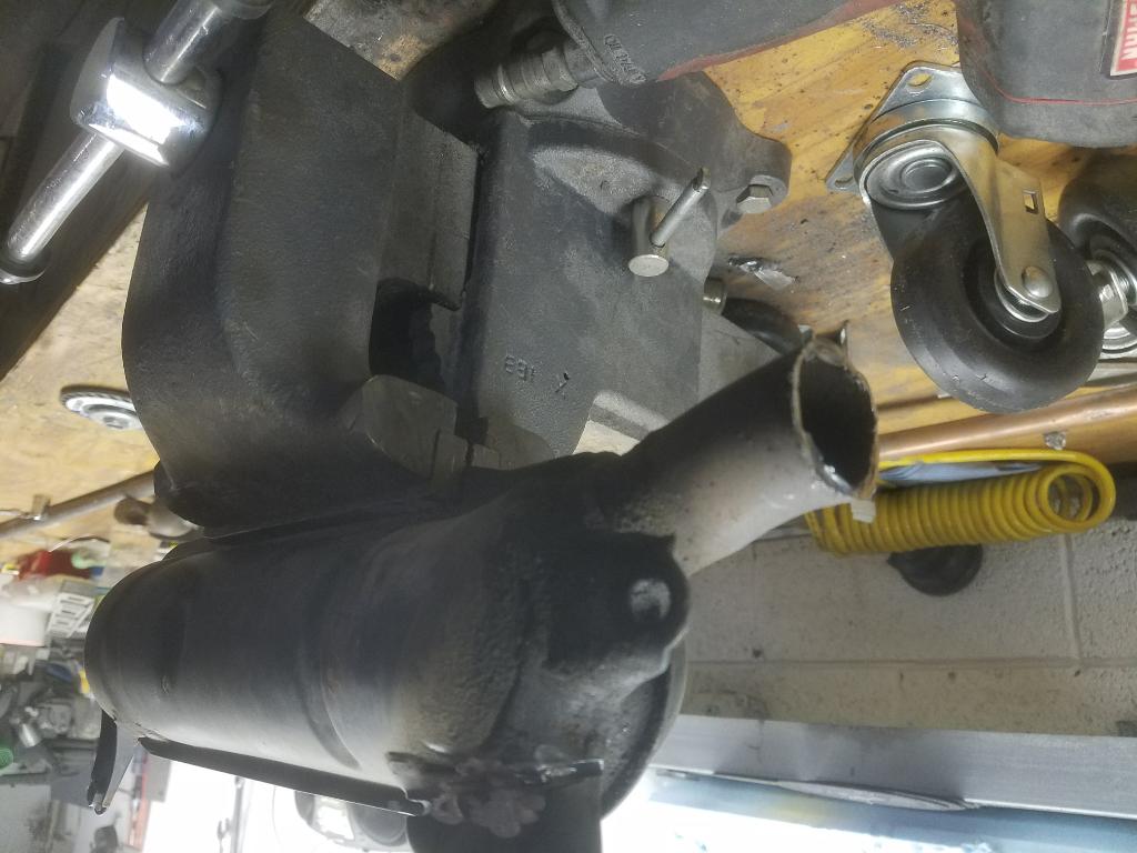

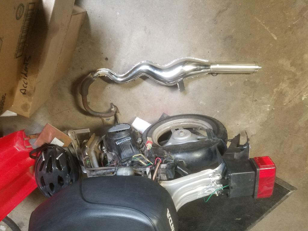

Re: Retrofit X1 49cc Expansion chamber to stock exhaust.
a few pics
- rps20180720_182123.jpg (94.21 KiB) Viewed 11022 times
- rps20180720_182225.jpg (83.95 KiB) Viewed 11022 times
the final mock up.
- rps20180720_183209.jpg (96.04 KiB) Viewed 11021 times
- rps20180720_183347.jpg (91.22 KiB) Viewed 11021 times
It sounds almost like a small dirt bike. After a rejet and some exaust tip size tuning I had it hitting 28-30 but it was very torquey from low to mid rpm. I'm using a drilled #74 jet. I took video of how it sounds, I might cut the studs to the silencer and pack it with dirt bike muffler material.
You got seriously lucky with that pipe dude. That one was a good choice to mount on there because of it's stamped design and no header pipe into it. The regular old pocket bike pipes have the header with two inches inside the chamber that wreck the pulses completely unless you repair it. Sounds healthy to me. Your top speed won't change all that much unless you can get it to rev higher than stock and get the gearing changed a little. If that is an 84 or 85 spree 28MPH is normal and 30 is pretty good really on flat ground. You may want to inspect the belt and measure the width against the specs in the manual. A narrow belt will give better bottom end at the expense of top end.
Also you managed to get the header the correct length for your needs by the sound of it. Header length is critical to the rpm range you want to get the pipe to work in. If the pipe and header don't give it might hit way too high and rpm making it gutless in the bottom and mid range
