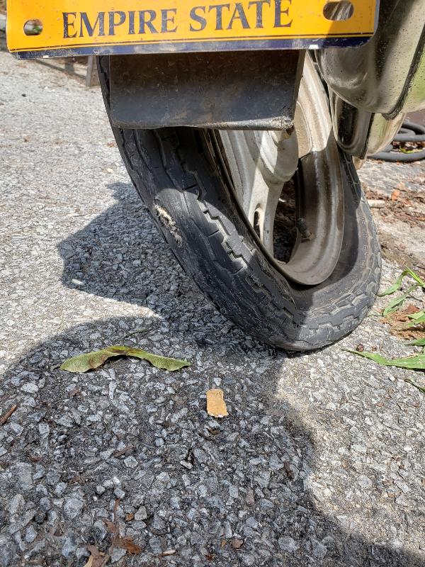

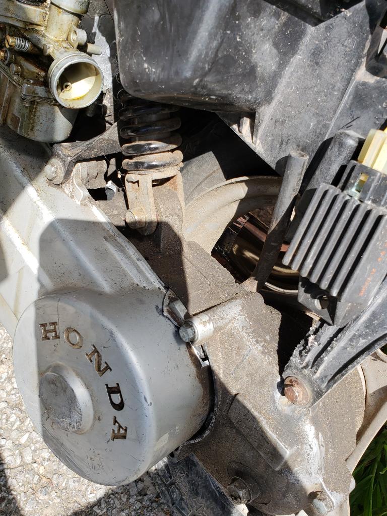

Of all the ways I could have spilled, the one I didnt think of occurred just a few hours ago. I was doing 30 on a straight away and when I hit a slight bump in the road, my driveline cracked in half, crooked my rear wheel locking it aswell. The rear of the bike swung to the right then bottomed out on the foot rails sending me sliding sideways. The whole time I'm still sitting on it as if I'm riding but I was so tense I didnt loose from. While sliding and holding the handlebars, my elbow touched the pavement. I slid into another dip in the road and that tossed me off the scooter and into a roll. When I got up I truly didnt know what happened. I know the engine didnt seize because it still kicked freely right after, but I'm just glad I'm okay and didnt spill as hard as I could have. If I have time I'll upload pictures of the damage, I just couldn't bring my self to take them at the moment.

Got a new motor coming, And a nitro filled shock aswell. Meant to say geared hub not heated hub below.
- Wheel locked in this position, the rim is seated perfectly in the heated hub, but the trans is literally in half.

- Crack is right above shadow on the bottom
- rps20180729_153925.jpg (156.43 KiB) Viewed 26880 times
- rps20180729_153959.jpg (146.12 KiB) Viewed 26880 times

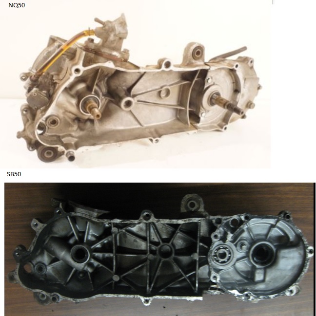

... so the motor case broke between the rear axle and crankshaft? I've never seen that failure.
The guys that use these as offroad bikes 1) are on dirt 2) those bikes don't last long. They typically bend the frame after 1 off-road session. I've fixed folded frames before but haven't ever seen someone break the Honda case. You're on the right track; run down a complete motor and strip that one for parts.

Me either, but recall Honda increased ribs in the SB50 case.noiseguy wrote:... so the motor case broke between the rear axle and crankshaft? I've never seen that failure.
Edit: Update - upon member ntonar's feedback, the 86-87 cases were observed to have increased ribbing. The parts fiche diagram for 86-87 incorrectly shows same ribs as 1984-85 Spree. However, the case p/n show the same P/N is used on 86-87 Spree as the 88 SB50.

Re: Cracked Driveline in Half, Wrecked Today.
...the SB50 is also a lot heavier than the Spree.

[quote="noiseguy"]...the SB50 is also a lot heavier than the Spree.[/quote]
For the curious - The delta at time of change was 14lbs. From the respective Service Manuals, the SB50 was 108 lbs (dry) and the '87 Spree it replaced was 94 lbs.
The original 84-85 Sprees were the lightest at 86 lbs dry, the '86 was 92 lbs.

[quote="ASpreeOfJoy"]...but I'm just glad I'm okay and didnt spill as hard as I could have. If I have time I'll upload pictures of the damage, I just couldn't bring my self to take them at the moment.[/quote]
Thanks for posting, and glad you are ok. I posted the SB50 case info to pass 'tribal knowlege' around. Since you are looking around for an engine, the SB50 gives one more option.I do not have an opinion that Honda had a breakage issue with the Spree case. I just note they beefed up the case.
