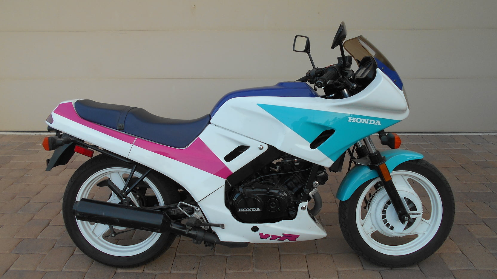

I came across this in Shimizu, Japan, today. Lots of mods on this one.. seat, rear deck, exhaust, front disk brake, wheels, headlight, dash, and more. Even though the rider's English language skills were equal to my Japanese language skills (both about zero), we had a good time discussing the mods and talking about riding one fast.. very enjoyable..
That is his girlfriend sitting on the bench in the background playing with her cellphone. This is her ride. Can anyone identify it?
Re: Official NS50F thread
I see a Honda wing.
Honda VTR 250 with an aftermarket cowl.
I never would have guessed because I had the '89 example.
- vtr250.jpg (181.21 KiB) Viewed 32588 times
