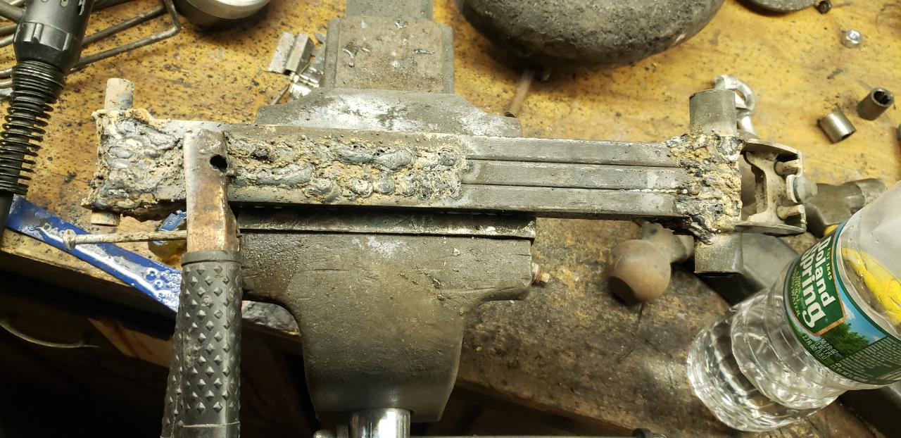

Hello fellow rider's i was to share my mock up of my 12 inch stretch for me spree, i wanted something simple and heavy duty so i used....
1/2 by 3 feet of steel cut into 3 bars
1 original spree mount
30 minutes of free time.
Sanding disk grinder
Welder
Cut them even and aligned them.
scooty 7.jpg (89.17 KiB) Viewed 10010 times
Used a flapper wheel to mock up a u shaped valley.
A little mock up....
scooty 3.jpg (86.21 KiB) Viewed 10010 times

Mock up tacked up
Mock up tacked up
Not tightened up but how far i will be.
scooty 9.jpg (87.69 KiB) Viewed 9999 times
Bent my tact welds till it was straight.
scooty 4.jpg (83.78 KiB) Viewed 9999 times

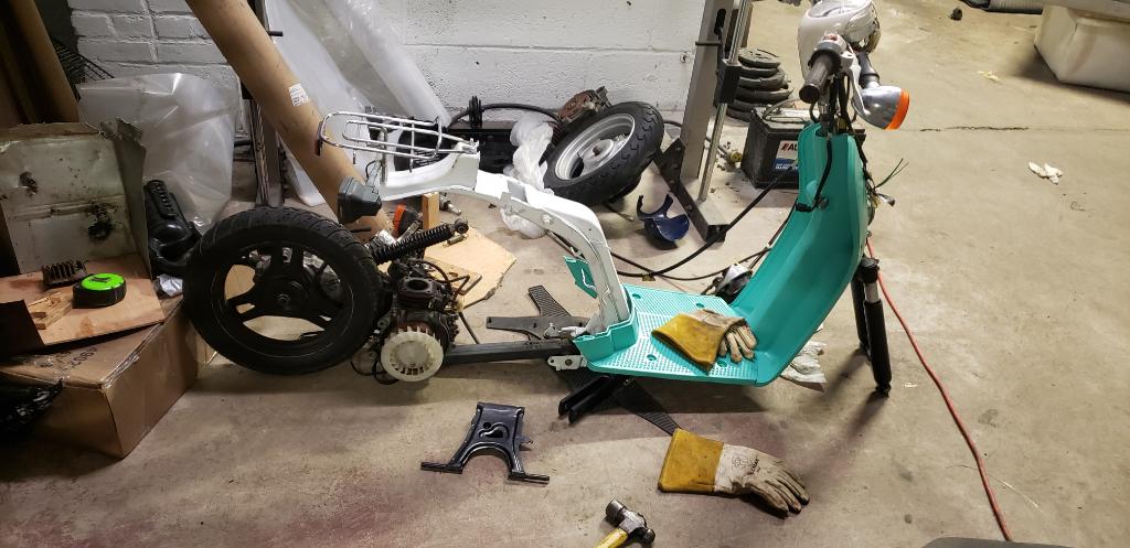

The dio motor would likely pop my welds lol, i have 1 or 2 more bars to add for less flex( if any). Another 1/2 thich for the side with more room and 1/4 inch for the opposing side with the tiny stub on the motor side of the mount. I have a friend who is going to tig what i mock up when that time comes for the dio. Im realy hoping to use my panels, worst case i will heat a razor and trim the bottom to fit. I have to cut the license plate mounts to clear room for the tire. I have some more stuff planned!

Made the mount a little safer by adding some metal as support. I will buy another piece for the left and right sides for more flex proofing. Got it straight enough.
