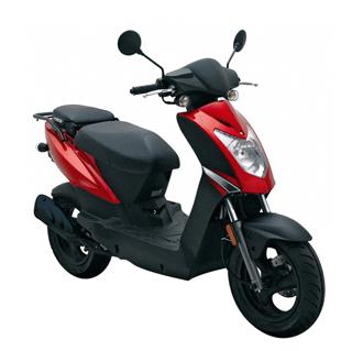

* File photo
Kymco agility_50_red.jpg (12.67 KiB) Viewed 77861 times
