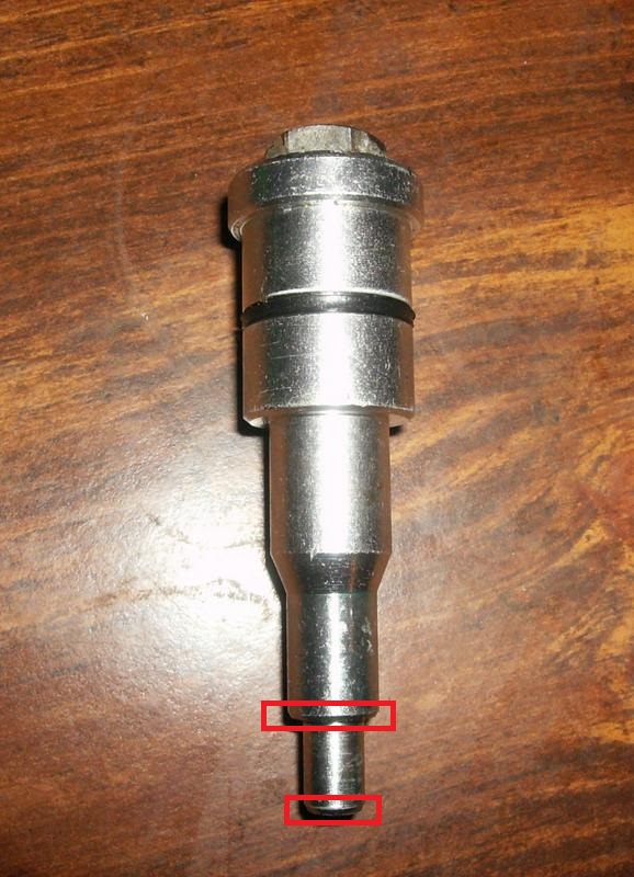

bonesv
Posts: 1616
Re: How do you get that oil pump plug working?
Post by bonesv »
I have found what may be this posters problem. He said his plug would not go all the way into the oil pump cavity. I have a early dio af18 case that has the small diameter crankshaft and I could not get a af16 oil pump all the way into the cavity. It would bind against the crankshaft when I tightened it down. I could not figure out why so I attempted to slide in an oil pump plug and it would not go all the way in. I measured the depth of the hole and sure enough it was not as long as the plug. I decided to use this motor for a 72cc kit so I trimmed the pump plug in 2 areas to get it to flush down in the case all the way, secured it from backing out and I will premix the fuel on this one. I remembered this post when I realised there was a slight difference in the af16 and early af18 cases so I will post this pic showing where I trimmed the oil pump plug about 1/8th of an inch. I did not want to modify the oil pump shaft to fit it fearing that it might not mesh correctly with the worm gear on the crankshaft and really make a mess of things :nervous: Also, I did have to use a special seal on the case to use an af16 crank which I had luckily already bought from Jiangwayne.com and I just looked and can't find them now so he's probably done selling them or ran out.........
the-culprit 1.jpg (192.42 KiB) Viewed 18822 times
kosmo
Posts: 16
Joined: Mon Jul 08, 2019 5:30 pm
Post by kosmo »
Wheelman-111 wrote: Fri Jul 12, 2019 11:09 pm Greetings:
O-rings come in different thicknesses as well as diameters. Perhaps it was bad luck on the original, not "square" when you pushed it in, or a sharp edge on your crankcase. After that maybe replacements are too thick to fit? Measure the pump bore and the plug diameters. Lawn irrigation suppliers have the best o-ring selections.
yea this one was my guess probably. i dont know, i dont think i hit it as i put it in. i took both halves with me too, to the hardware store and we put them together. maybe i got it wrong. they didnt have many more o-rings for what was my diameter. there was a lot but no more choices for me. maybe if someone would give out the size of the replacement parts when you get them, my local hardware store has a bunch of stuff.
no, the plug went in there all the way. it would go in there and seat.
