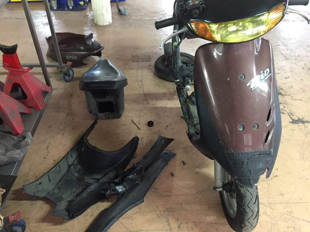

They look to be af27 frame models. No af18 in the pic. I think he’s referring to the motor af18e
Re: Help: Honda DJ1RR (SE50) with Dio front end
I am a bit of a hoarder so won't be selling much at this stage. I am glad I've kept and gathered some of these scooters up as now I can use all of the bits.
The black Dio ZX is a genuine AF28. I will use the wiring loom from the parts/wrecked AF27 frame you see there. I won't be using its front end unless I really really have to.
The other rough Dio is an AF27. Not sure what to do with that. Everything on it is slogged out and stuffed. It will be a parts bike but for now I will leave it complete because that is the easiest way to store it and move it.
The DJ1R as you guys have suggested is not an RR. I was always going to modify this bike. That's why I bought it without the engine. I will trial run using the stem and front end from the parts/wrecked AF27 frame.

I've done a quick google research.harleyracer59 wrote: Mon Dec 30, 2019 6:05 pm I think yours is a dj1r (af12) not a dj1rr (af19) your scooter has single head light bulb, no rear fairing scoops, af05e engine (originally), and I don't see dj1rr on your scooterexcept for thbe forks. dj1 and dj1r have a trailing link under shock like the 85-86 aeros.
dj1=87 af05e engine dj1r= 88-89? af05e engine dj1rr 90+ af18 engine.
we didn't get any of these here. we had an se50 elite af05e= 87, sa50 elite af05e 88-93, sb50 elite non variated af05e= 88-92 sa50 elite af16 = 94-01
honda didn't seem to care if they confused the crap out of us. lol
you have a cool collection of scoots though.
you have a zx front end sitting right there. pull it offthe black zx and try it on your dj1r. then report back your findings. if the top corners of the fork legs hit your plastics, try a fork stem from a honda af55. aka metropolitan
then pull the handle bar set off the af18, put it in a box, and ship it to me!!!! lol
seriously though, I wanna buy that handle bar lights switches speedo. let me know if you wanna sell them. thanks
Is the Honda AF55 Metropolitan a 1992-1999 Honda Giorno (2-stroke engine)???
http://www.motorscooterguide.net/Honda/ ... iorno.html
I think I'm better off to stick with the Dio stem and make that work as there aren't many Giorno in NZ and finding a wrecked one will be a pain.

Ask and you shall receive. This is being delivered tomorrow. The guy belongs to a facebook group. I was asking someone else about there Dio they had for sale and he messaged me. To easy and exactly what I need! Genuine AF35 Dio ZX. Very rough, engine is junk. Comes with complete front end and a set of live plates (an NZ thing).
I'm going to use the front end and the AF35 headset on the DJ1R project.
