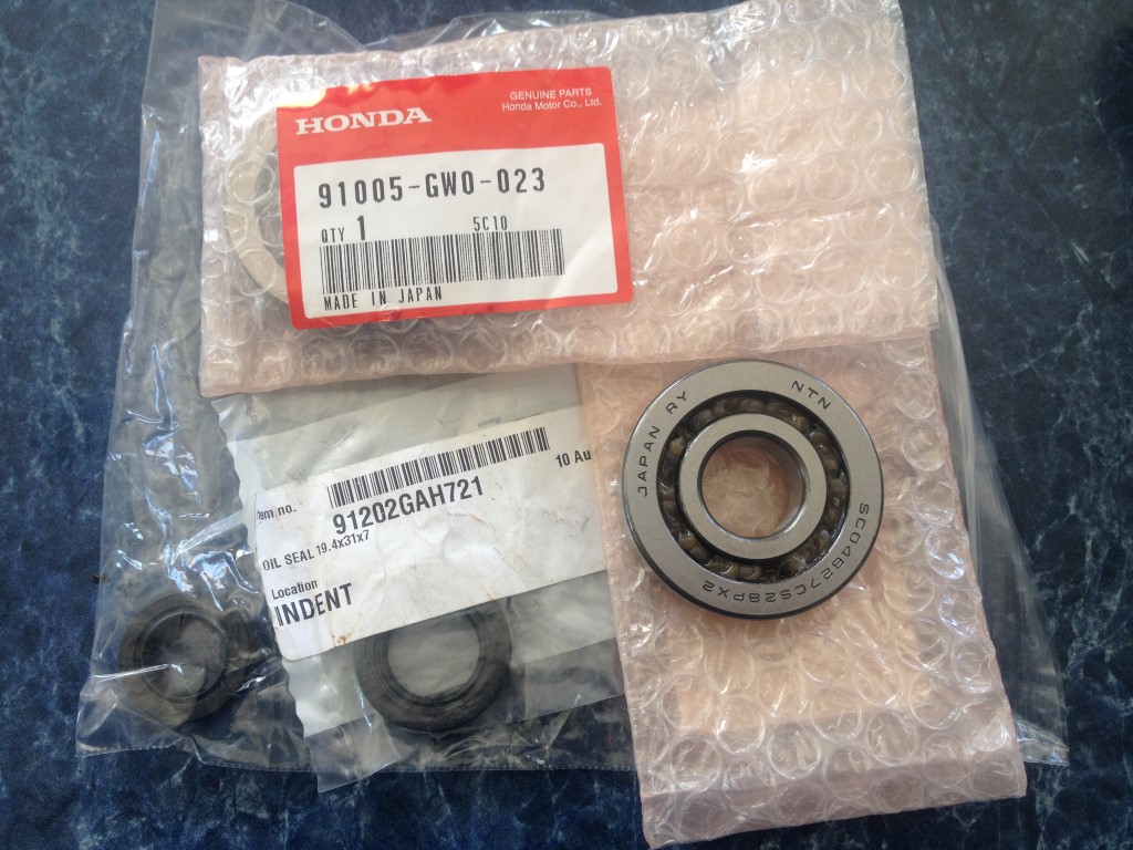

Af18e large crank bearing part number ( 2x required)
OEM# 91005-GW0-023
Size 20mm ID x 52mm OD x 12mm Wide.
Alternative number from the NTN bearing on my crank.
NTN# SC04827CS28PX2
OEM Oil Seals:
Large seal for pulley side of crank
OEM# 91202-GAH-721
Size: 19.4mm ID x 31mm OD
Small seal for magneto side of crank
OEM# 91201-GK8-003
Size: 15.6mm ID x 25.5mm OD.

Now we are talking.
Bearings AF18e (Medium).JPG (210.19 KiB) Viewed 15217 times
