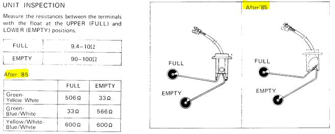

Trying to figure out did Honda use a 3 or 2 wire tank level sender on the 1985 model. Mine is 3 and my harness has 2 wires. Gage just sits past E, maybe moves lower some with green ground connected and one or the others connected. I removed the sender and checked for resistance change and that looks good.

85 and 84 Sprees used a 2 wire fuel sensor.
When a 3 wire fuel sensor is used in 84-85 Sprees, the readings will be low as you describe.
