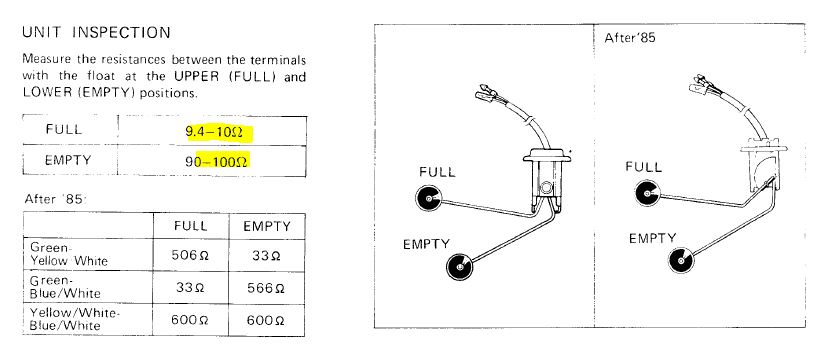

-- Fuel Sender info from Service Manual
This details the resistance differences
