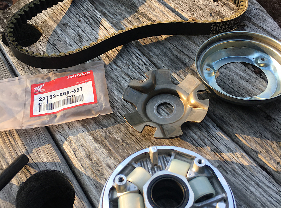

Got my parts in and decided to open it up today. The belt was badly shredded, only 2 teeth remained. The variator was full of hardened grease, and the weights all had 2 or 3 flat spots.

All cleaned up and installed without grease.

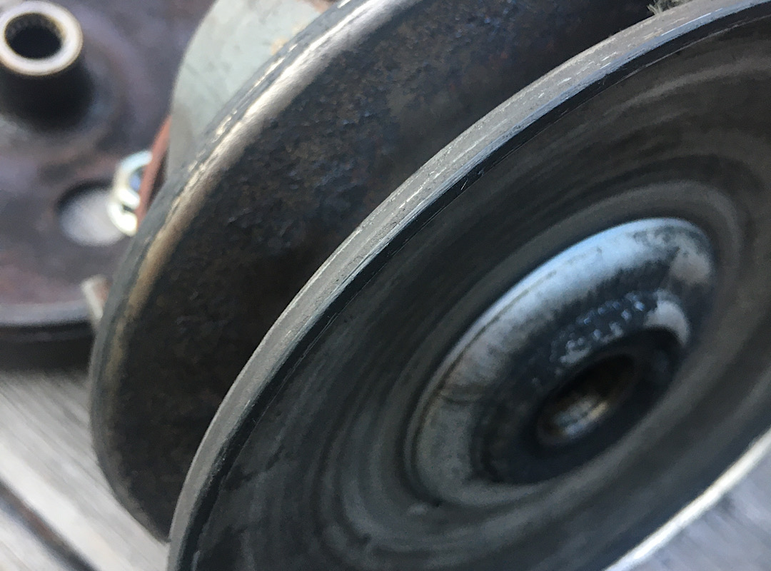

Also, is the pulley plate supposed to be tiered like this? Or is this from the belt?

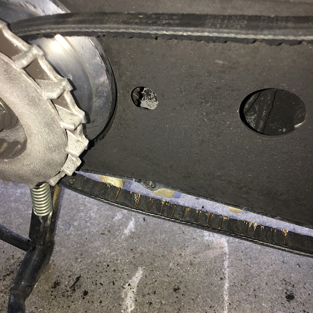

Well, the new belt got cooked and exploded when I was going wide open down a long straightaway. Thank goodness it didn’t get crammed up enough in between the bell/pulley/variator cover to jam the rear wheel from rolling. That’s what I get for not taking the clutch off to inspect when I worked on the variator. The clutch pads were pretty much gone, and the shoes had completely destroyed the inside of the bell, heat must have been crazy high. The face of the pulley was pretty rough as well.

Posts: 4816
Re: NH125 Aero roller guides
Tough luck that one... :cry:
I exploded a belt too, but it was the original that I put into service without checking condition.
Then I rode it a good 100 miles non-stop until she blew.
That's when I went looking for a belt (2012 probably), and found them very expensive and hard to get.
My thread on Ruby gives all the info I found for replacement.
Never had any trouble with a the alternate size that I chose.
Hope you can get some replacement clutch and variator choices to keep the bike going.
MrJumps
Posts: 1339
Post by MrJumps »
So I would replace the variator and clutch assembly. I hate to send you on that quest but that pitting is gonna tear up belts. Scooter swap shop has performance aftermarket options or ebay will be your best bet. Make a wtb post in the for sale thread. But I personal would not reuse that pully setup on the clutch or that variator.
