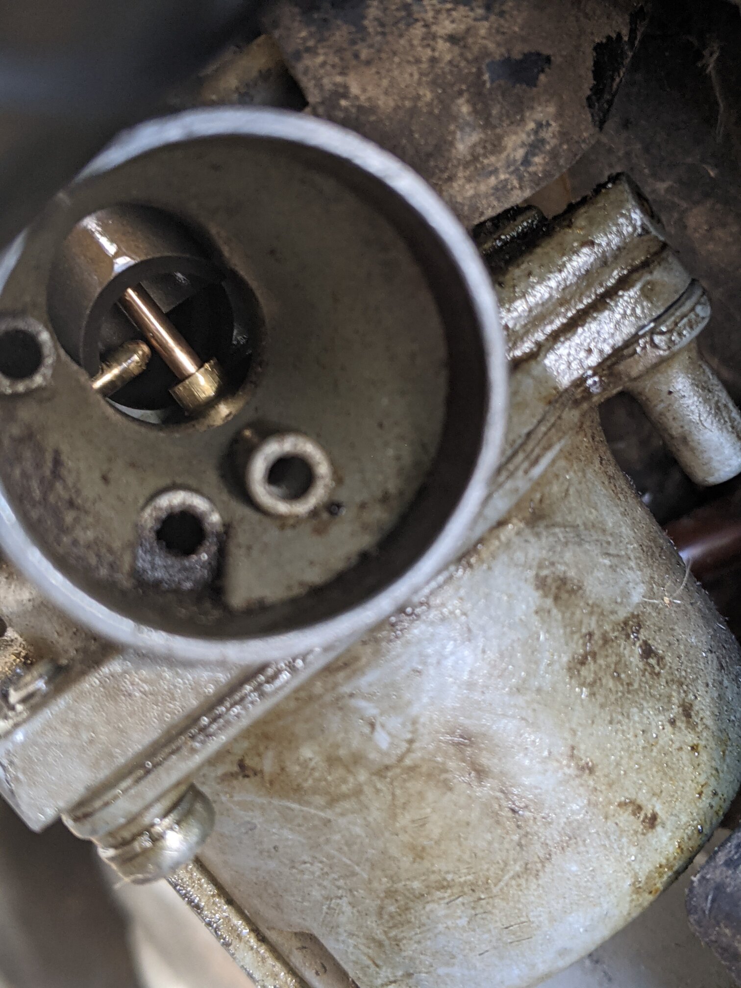

Took a couple pics so you'd get a better idea of what I'm looking at.
Here is inside the carb where the air boot attaches. I'm guessing based on your comment that my barrel is set too high and should be nudged down a bit.

Posts: 4816
Re: '85 spree idling really high
URGENT NOTICE ! ! !
Do not "NUDGE" down the barrel. Stop.
Take the barrel out, rotate it 180 degrees, and insert it back into the chamber with the GUIDE PIN aligned with the LONG GOOVE on the side of the barrel. It should fall all the way down until it touches the tip of the idle speed adjustment screw.

Mystery solved. That barrel be backwards….either that or its a throttle cable issue. Too short, massive kink, etc. Also when you unscrew the carb cap there should be a long spring between the barrel and cap. That spring is what forces the barrel back down to idle position when you let the grip go. If that spring isnt there, you’ll twist the grip and revv the motor and it will stay there….yay, cruise control!

I tried to rotate the throttle barrel 180 degrees but it didn't seem to fit that way. Here are a couple of pictures to help show the orientation of the barrel. The first picture shows the way I have the barrel going in, there is a long slot on the other side of the barrel that seems to line up with the little groove inside the carb. The second picture shows how deep the barrel goes when 'fully seated'. The throttle, when pulled, moves the barrel up out of the way and seems to be working correctly.
I know motormike said my barrel is backwards, any idea of why I couldn't get it to flip around/do you still think I have it backwards. Thank you for the help. I'm a noob.
Posts: 4816
The barrel is good, but the idle adjust screw is fully seated and that is WRONG.
Turn that screw back out ALL THE WAY until the idle drops and adjust for proper rpm.
