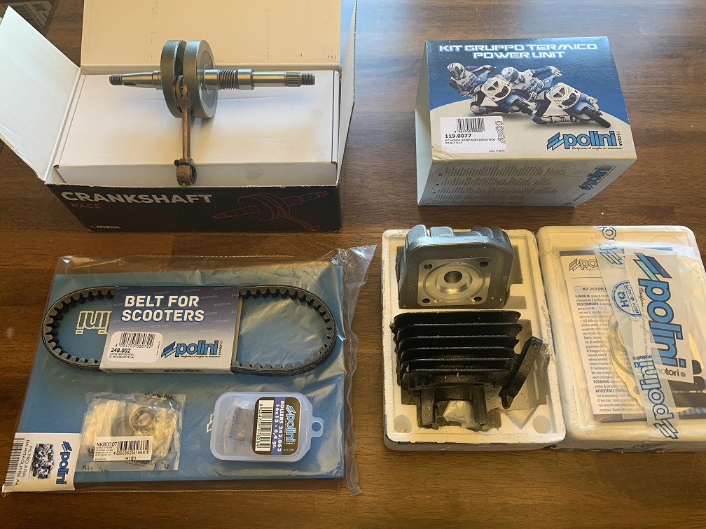

A box of fun arrived today!
Polini Contessa top end
Athena Crank
Athena Crank

bainer1290
- Posts: 7
- Joined: Tue Aug 31, 2021 10:39 am
Re: 1997 Honda Dio SR AF18
I was checking out the Athena crank wrist bearing that it came with and its 12.7mm wide. The Polini piston has an opening of 15.3mm, so about 2.6mm of space. The oem piston measured 15.1mm and the oem wrist bearing is 14mm, so leaving only 1.1mm space. No thrust washers were included so am I good to run it with this spacing?
- piston.jpg (584.17 KiB) Viewed 49846 times
Yes, the cylinder will keep the piston centered once installed.
bainer1290
- Posts: 7
Yes I was more concerned about the pin bearing, the piston and rod should stay centered but the bearing can move freely. However it would still have 85-90% coverage on the rod bore even if it was all the way to one side or the other so I assume that is a non issue?
Get a wider bearing. The ones I run are like 15.7mm or so. The small end bearing that Athena provides must be for a different slug. The bearing cage can hang out either end a bit, thats fine. Even the rod on the Malossi MHR is 12.5mm or something so the width of the Athena rod is spot on. SSS has good small end bearings on hand.
bainer1290
- Posts: 7
Ok I figured that might be a bit too much free space, I might just order an oem Honda one in as they are a decent price $10
