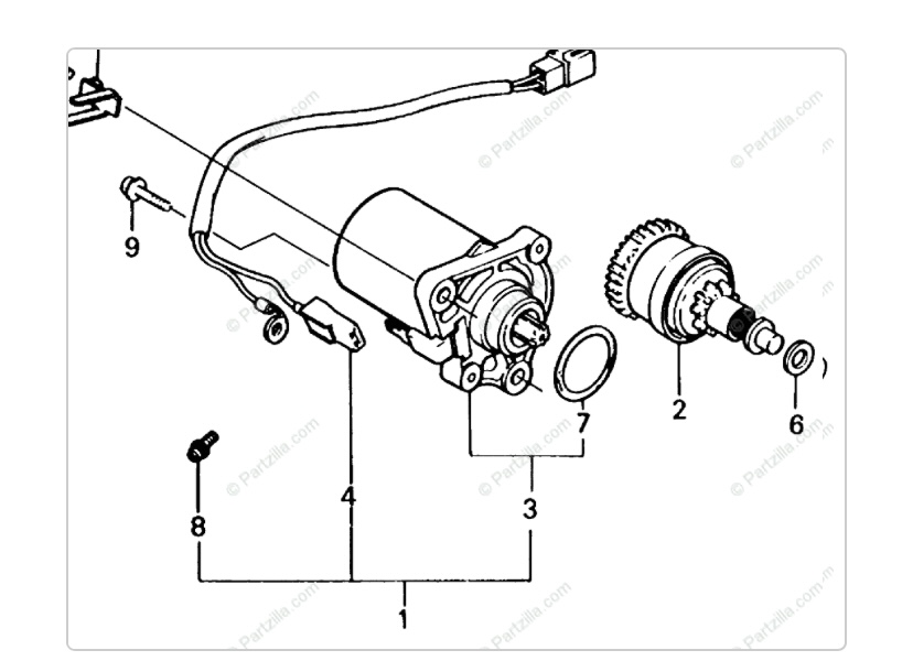

Anyone know if this washer #6 in the diagram is the one that holds the bendix together or separate?
Re: 85 Spree - Not enough power to turn over fast enough
It does look to be a unique part.
The washer on the Bendix is counterbored to house the retaining ring on the Bendix shaft.
But the parts fiche description is WASHER, PLAIN (10mm) 90401-437-000. A photo(found on eBay) shows a plain washer.
