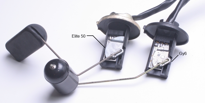

txaero121 posted some pics of a Honda Aero 50 3 wire gauge he's working on. He noted the GY-6 sender looks very similar and might be used for parts.
I tore down a GY6 sender a few years back and it might even work as a replacement - if the float/float arm are swapped.
-- Let's dive into some photos

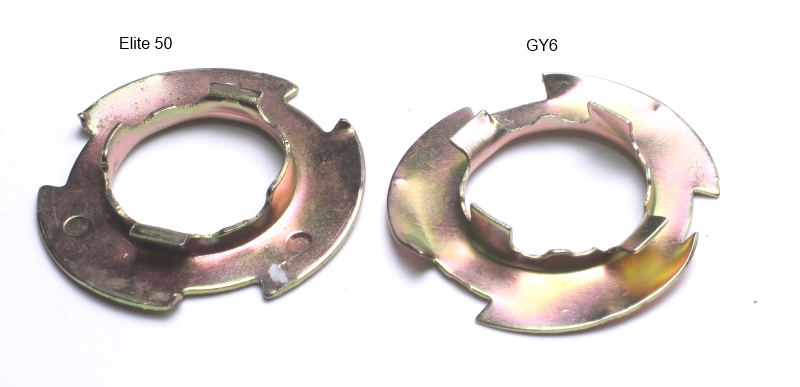

Elite 50 Left/GY6 Right

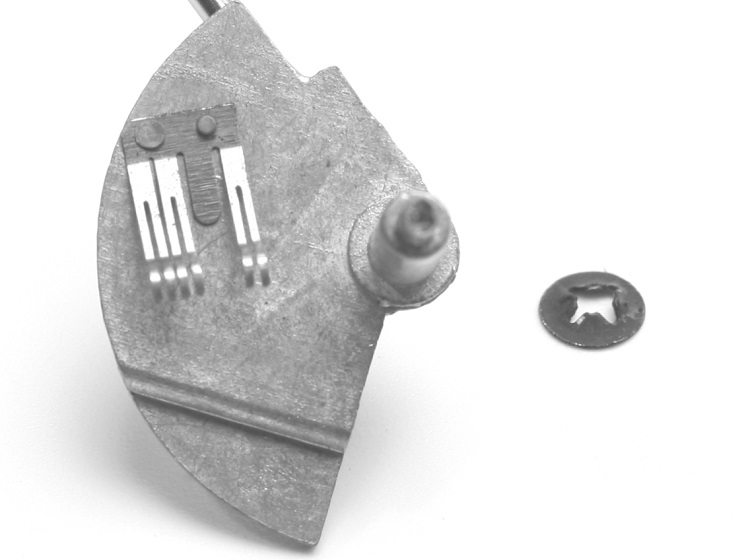

Main difference is the float/float arms differ. The GY6 sender mounted up fine in my SA50 tank.

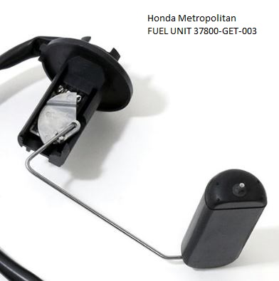

Edit: Add - Honda Metropolitan sender parts also look promising. Photo taken from an online seller of OEM parts.
Fuel sender hold down. Elite 50 is a better looking part but IRC the GY6 fit on the SA50 tank.
Honda 3 wire vs GY-6 Fuel Sender

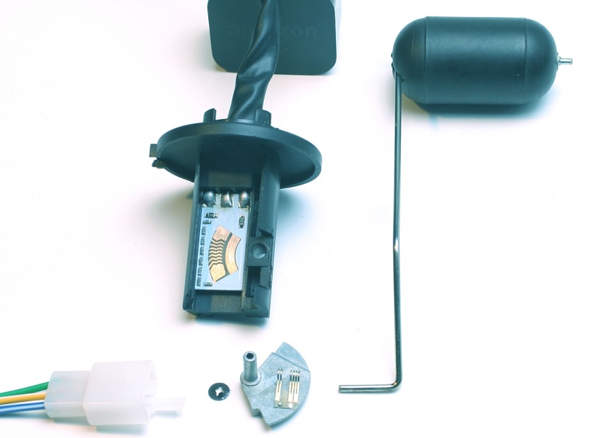

GY6 Parts Breakdown

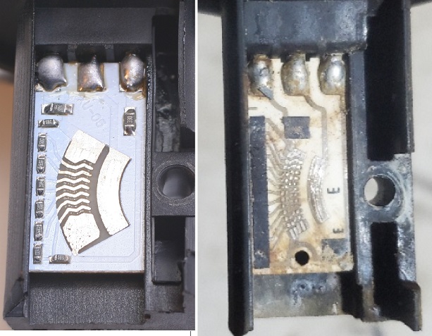

It did appear that the GY-6 float arm could be swapped out with any Honda arm I've seen. GY6 Wiper GY6 Circuit Board

Re: Honda 3 wire vs GY-6 Fuel Sender

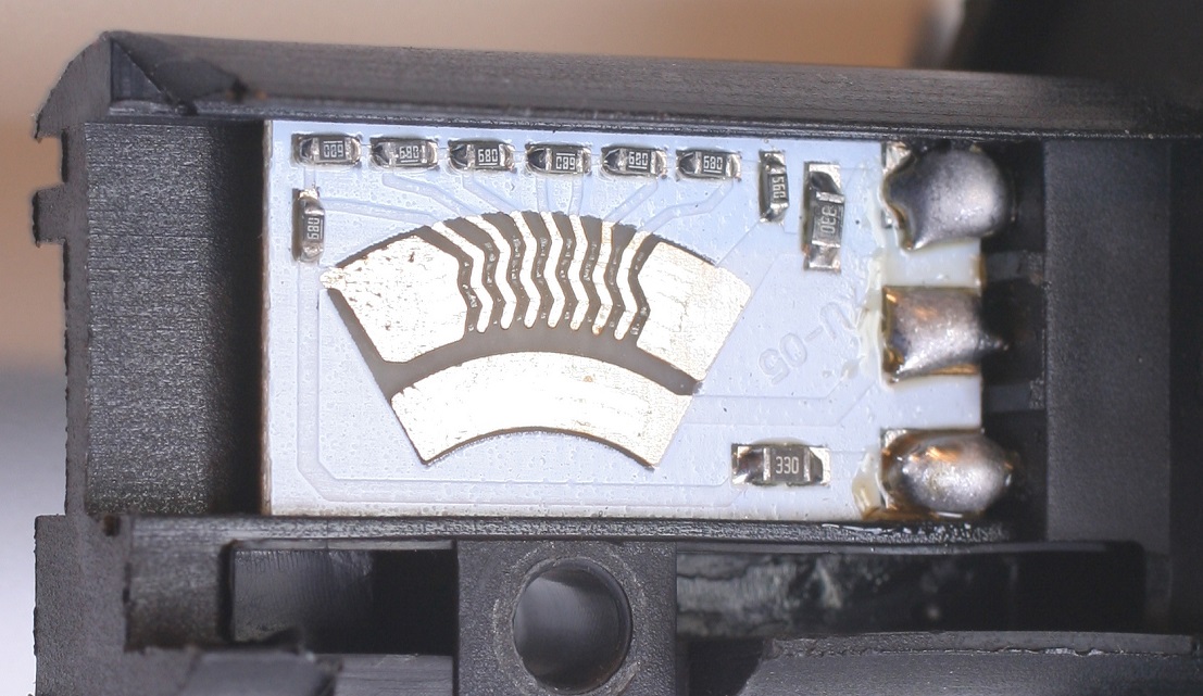

GY-6 Sender PCB (Left)/ txaero121's Aero 50 PCB (Right) -- Thanks txaero!
We should add some width measurements here. IRC between the Elite SA50 and GY6
the parts looked very close to the same...
The GY-6 has only 8 steps of resolution vs 12 on the Honda. We'll compare overall resistances later.

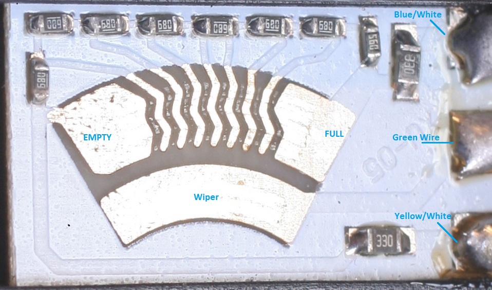

GY-6 Fuel Sensor Resistance
Instead of using a meter, we'll trace the circuit.
-- Determine value of each resistor --
The first 2 digits printed on each resistor is the base value, the last digit (0) is a multiplier of 10x.
In this circuit board, all multipliers are (0), so there is no x10 multiplier factor.
Green (Wiper) to Blue/White when FULL = 33 ohms
Green (Wiper) to Yellow/White when EMPTY = 33 ohms
Green (Wiper) to Blue/White when EMPTY = (7 * 68 ohms) + 56 ohms + 33 ohms = 565 ohms
Green (Wiper) to Yellow/White when FULL = (7 * 68 ohms) + 56 ohms + 33 ohms = 565 ohms
Resistance between (Blue/White), (Yellow/White) wires = (7 * 68 ohms) + 56 ohms + 33 ohms = 598 ohms

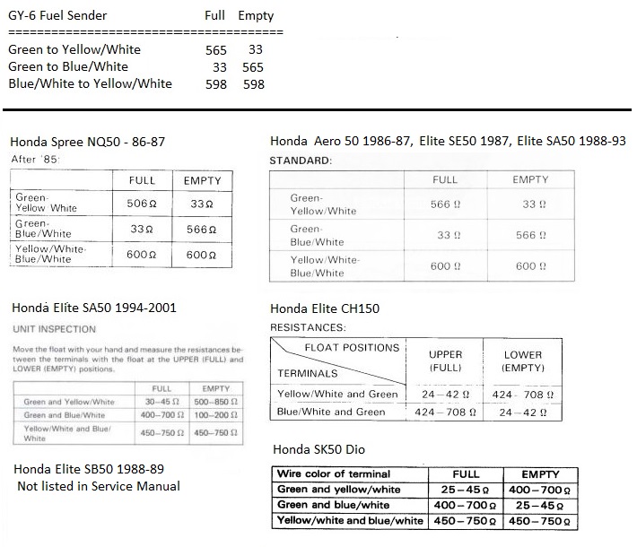

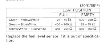

Comparison of GY-6 Fuel Sender Resistance to Various Honda Scooters
The GY-6 is a virtual clone (in terms of resistance) for the Honda Aero 50/ Elite SE50/ Elite SA50 for years listed below
All other models showing resistance ranges have the GY-6 within the valid value
The Spree is the only scooter showing a slight difference on the Green to Yellow White (FULL) condition of 506 for Spree vs 566 for GY-6
Given the range of resistance tolerance for other models, a reasonable option for someone to try?
Edit: Add - Honda Metropolitan sender resistance is also within range. So 'Met sender may be the high quality option - its around $50.

That's crazy high. At that price we can get a new part - I added the Honda Metropolitan sender into this thread, it's 1/2 that price. It looks that it would work with a float arm assembly swap.Another thing most people are asking 100$ + on a used sender on ebay that who knows if they work or how long it will work !!
