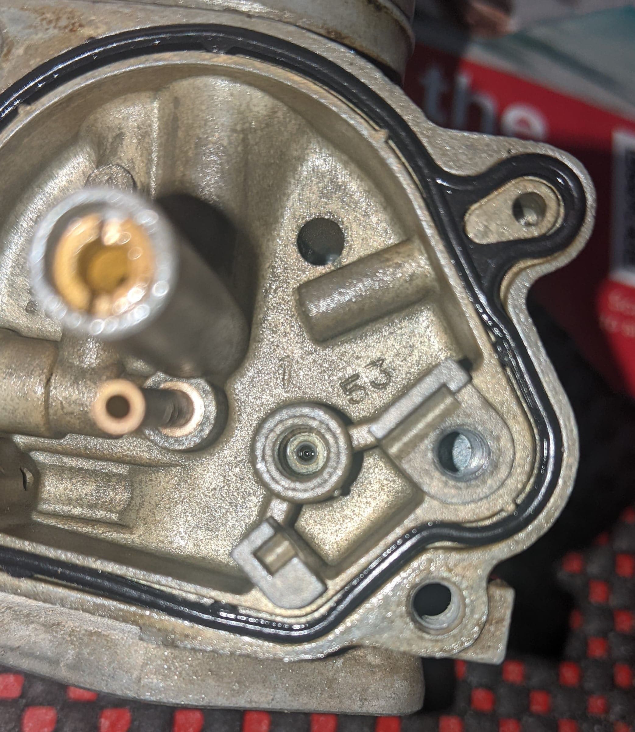

Hey guys,
When I let my spree sit for a couple days it leaks gas out of the carb and won't start unless I pull the throttle slide out and inject a few ml of gas.
See the picture, it looks like the gas is leaking from here. I can't find a carb diagram to see if I'm missing a hose. Or what the function of this nozzle is for.
Any advice as to why this is leaking from there or what this nozzle is would be helpful.
Thanks a bunch guys.
- PXL_20220326_233516109~2(1).jpg (228.44 KiB) Viewed 20091 times

That's the carb bowl overflow nipple.
http://hondaspree.net/wiki/index.php/Ca ... n_of_Lines
When the overflow leaks fuel when sitting there are two issues present:
It's up to owners or dealer service to periodically verify both fuel shutoffs are functional.
Otherwise we're just a bit of debris from a tank of fuel dumped in the garage...
For me that's where the furnace lives
- The petcock is not sealing as it should with no vacuum present
- The carb float needle is not sealing against its seat properly

Re: 85 spree carb leaking gas from carb
Thanks for the info!
I just recently replaced the carb float needle. I read that the float can get cracked and let gas in, then it won't press on the needle to seal. So, I'm planning to pull the carb back out and checking the float to see if gas is in it.
For the petcock, I haven't done any maintenance on that since i got the spree. Is the petcock not sealing something that I can fix or better to just buy a new one?
- Posts: 3487
Checking the float is good. The needle seat in the carb body can be an issue too.I just recently replaced the carb float needle. I read that the float can get cracked and let gas in, then it won't press on the needle to seal. So, I'm planning to pull the carb back out and checking the float to see if gas is in it.
I've seen some use a Q-tip and toothpaste to clean the seat. Another idea is sharpening a dowel to the seat angle instead of the Q-tip.
There are pics of some seat issues on the 'wiki - scroll around 2/3 down.
http://hondaspree.net/wiki/index.php/Ca ... ture_Guide
Sometimes the petcock can be removed and flushed out. There's a fine mesh strainer in the tank you can clean while it's out.For the petcock, I haven't done any maintenance on that since i got the spree. Is the petcock not sealing something that I can fix or better to just buy a new one?
Fix or replace question - if is the original part, 37 years is a long time. However, replacements are all aftermarket.
The carb float seat looks good from what I can tell. The seat issues link you shared had some pictures of what damaged seats look like and mine looks clean. The needle looks good too.
When putting the float body back in, I was careful to look that it was putting pressure on the needle when pushing up.
I took off the petcock and it looks like there is no way in that sucker. When looking in the hole where it connects to the gas tank, I don't see a screen. Couldn't find anything wrong with it but don't really know what to look for.
Thanks for all the help.
Well guys, bought an aftermarket petcock. It came with a screen but the screen wouldn't fit from the underside of the fuel tank. My tank looks clean and not rusty on the inside and the petcock that was original didn't have a screen so I installed the new petcock without the screen.
I'm still dripping gas out of the same spot as shown above. Is adding a fuel shutoff valve on the gas line into the carb a reasonable option?
Thanks for your thoughts.
Adding an inline petcock is just fine accept for access to operate.
Your new petcock should have stopped the drip.
New petcock not working.
