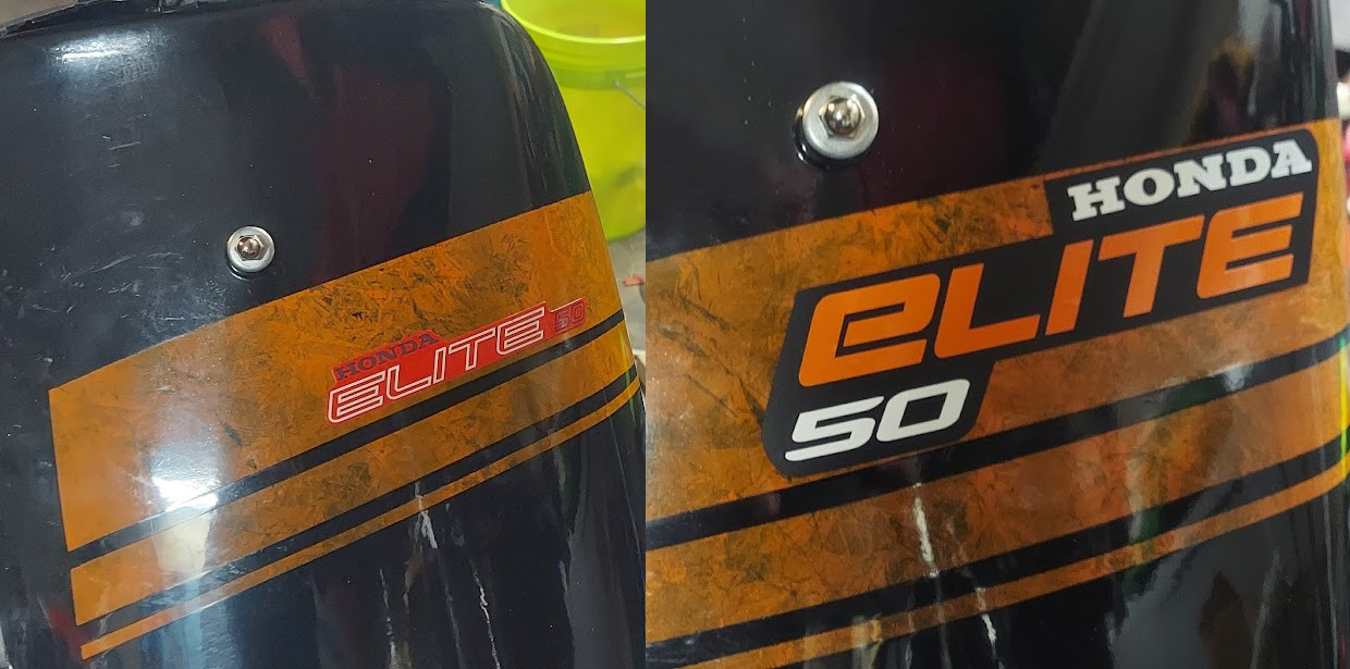

I'll have to put in more pictures of the new Jog airbox I swapped in once I get the back end plastics back on and polished up(Whole bike is due after miles and miles of riding). Meanwhile, my wife bought a Cricut, and wanted to have fun. Before on the left, after on the right. I think she knocked it out of the park. Matte black vinyl backer with gloss white and gloss orange overlay.
