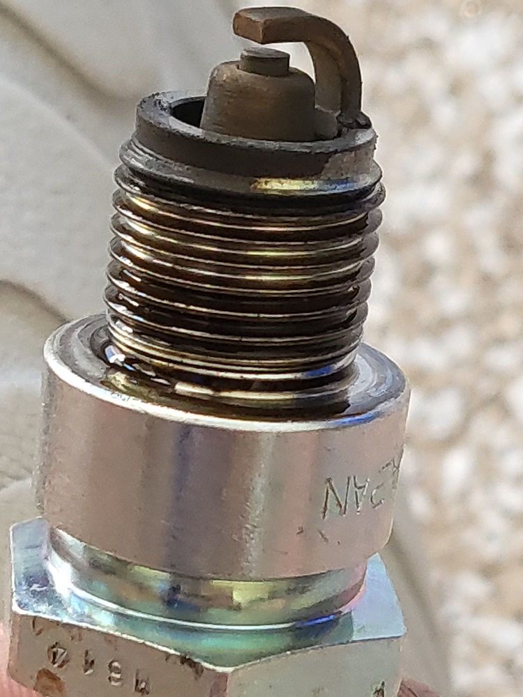

Wheelman-111 wrote: Sun Sep 04, 2022 3:42 pm Greetings:
Presuming your temp sender is a 14mm under the spark plug, 300F. is definitely NOT a problem. It might even indicate your mixture is a bit rich, if anything, so you're leaving some power on the table. 350 or so is ideal, 380 indicates caution, and 400 is really risky. What does the spark plug look like?
Wheelman, you are correct, I have the TrailTech CHT that goes under the sparkplug. I went down a size to an 86 main, and the temps stayed about the same. I should mention, I do have a higher temp BPR8 sparkplug in there to try it out, do you think I would be better off with the standard BPR6 plug?
It's pretty clean after a good ride this afternoon, lots of WOT:
Spark Plug.jpg (218.21 KiB) Viewed 25014 times
Thanks everyone for your input on this, the fine tuning is always the hardest part but I think I am almost there. She runs pretty well now, no stalling, I am hitting 35 MPH with my "substantially over the weight limit" self on there. :smile: That is quite a bit faster than I can go on my stock '85, but I know those are one of the "slow" years.
