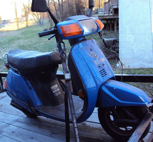

Pictured below is the only 80 I've ever owned, and never got it running right.
Is it completely stock, or has it been modified ?
Sounds like a fuel delivery problem.
We have member who is familiar with the Aero 80 intimately.
I will send him a message and try to have him reply here. Member is "Breaze"
- Aero 80 002.JPG (117.47 KiB) Viewed 13111 times

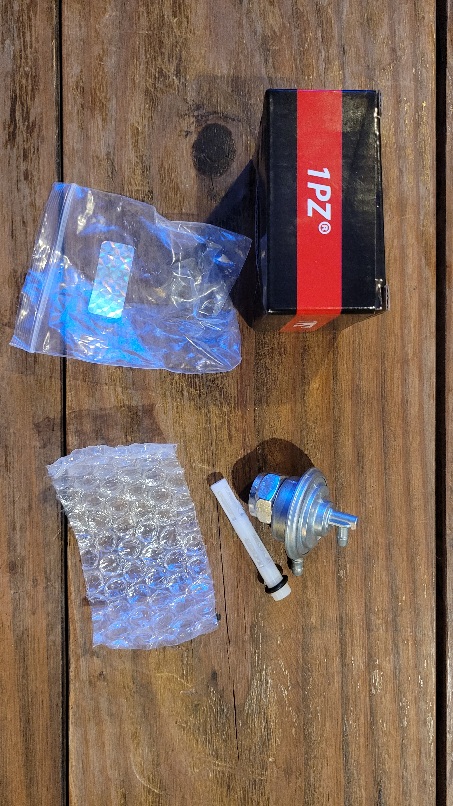

Re: loss of power after 10 miles
I've found this brand to be reliable as far as size listed - 14mm.
- 20221214_211924.jpg (197.38 KiB) Viewed 13071 times
