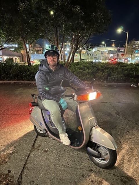

Thanks motormike and breaze for the responses! I'm Scott, 38 from Seattle.
Mike, you have the Aero of my dreams. I love that blue '85 version with the extra storage compartment.
Here's mine ('84):
Scott and Aero 80 - 2023 Medium.jpeg (120.24 KiB) Viewed 221868 times

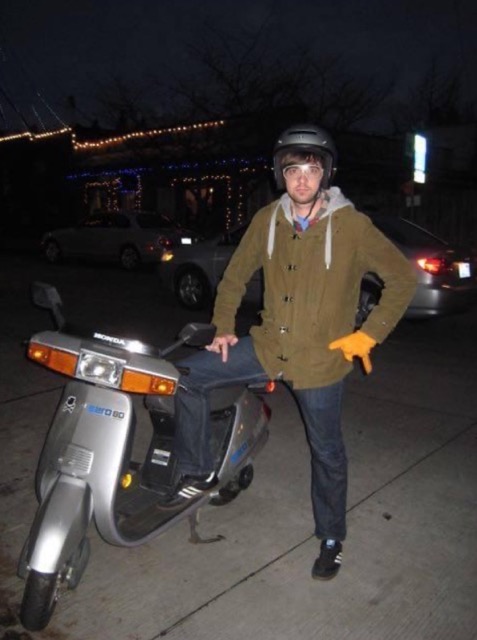

ORIGIN STORY
I had an Aero 80 back in 2014 (I think it was an '83), and loved it. It was pure joy riding that thing around, and I never had any mechanical issues.
Scott and Aero 80 - 2014 Medium.jpeg (55.02 KiB) Viewed 221868 times
I lived in an apartment in a densely populated area at the time, so I had to leave it sitting out on the street all night. And was stolen, twice. The first time, I found it a mile or so down the road, the plastic body around the ignition had been broken away and presumably it was hot-wired. I brought it back, and then it was stolen again a couple months later.
