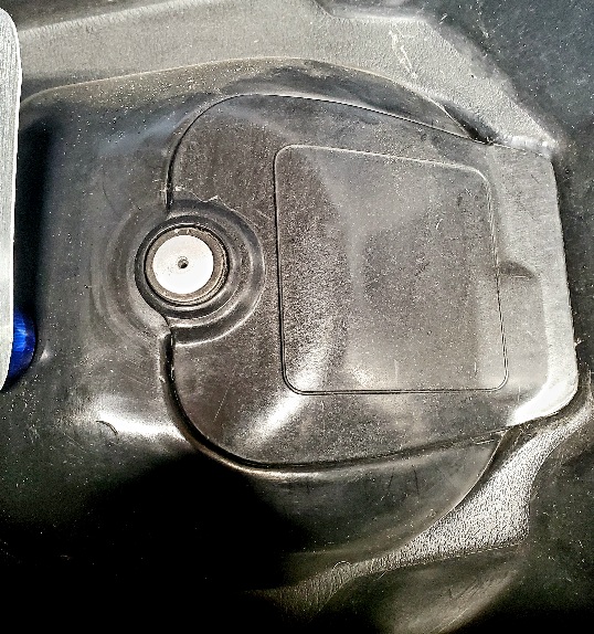

The panel under seat, has a rivet. Is this correct.
See pic. Anyone have pics to share.

Yes. The AF05 version had the plug vertical in the center and was accessed through this hatch. The AF16 moved the plug angled and installed from behind. (If you have skinny monkey hands...). So they sealed the plastic pet carrier with a giant rivet.

The access panel is a neat idea in pinch while youre doing roadside repairs/diagnostics but they snap off rather easily. Maybe 25yr old plastic has something to do with that.
In the comfort of your own garage, I suggest just removing the seat bucket for better access. Do it a few times and it comes out in less than 5min.
