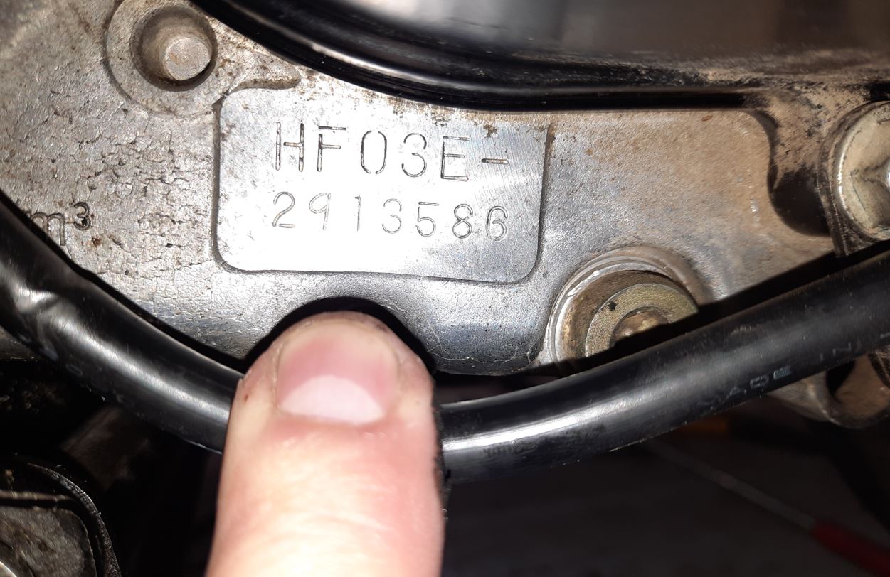

What year is this engine? From what I was able to gather from multiple searches, I *think the engine is a 2005? I am pretty sure I need some new O-Ring/Carb parts. (read further 😊)
(Insert Pic)

I can confirm that the engine serial number is AFTER the year 2000,
but could not determine exact year.
