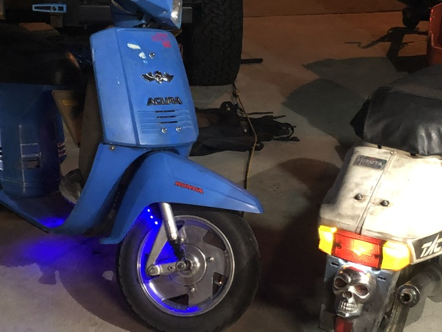

You could always buy some Japan alloy wheels. They’re 4x110? Bolt pattern and a ruckus/zoomer rear hub bolts to them and for front i use the elite 150 front hub. Same bolt pattern. But it has 105mm diameter drum brake. For upgraded stopping power.
