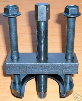

Make your own tool to pull them off. Get a timing gear puller ($15) and a thick plate of metal and a couple of long bolts (5/16 bolts should work). Drill a couple of holes in the metal to put the bolts through and attach with 2 nuts each and cut a slot for where the cranshaft will fit through in the middle of the metal. Slip it under the bearing on the cranshaft and torque down till it comes off. Kina like this tool:

KHPower
Posts: 66
Joined: Mon Jun 18, 2007 9:33 pm
Location: Nebraska
Post by KHPower »
I may do that , good idea.
I was planning on just leaving the bearing sit on the crank and when my part is ready (crankcase w/new sleave) pound it gently on there because thats where the bearing is gonna end up anyway regard less if I remove it.
Good idea? not sure ?
