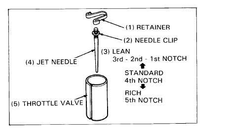

When I reassemble the carb I put the neddle 2nd notch from the top, could it be my problem?

You should NOT me messing with the throttle needle clip setting. Put it back to the default setting or you will most likely lean it out and kill the engine. Do that first thing before messing with anything else.solstice wrote:I cleaned my carb and now I don't have idle at all wen the engine is hot. Wen it's cold, it's start well and idle poorly and wen it's hot, I have to give a little bit of trottle at the red light because the engine die. I tried to play with the trottle screw but nothing happen.

I think I made a mistake when I reassemble the needle.
Because of the (2) needle clip on the picture, I put it on the 2nd notch but it's the 4th notch from the top that is suppose to be, am I right?

Yes, it should be at the 4th notch from the top.solstice wrote:I think I made a mistake when I reassemble the needle.
