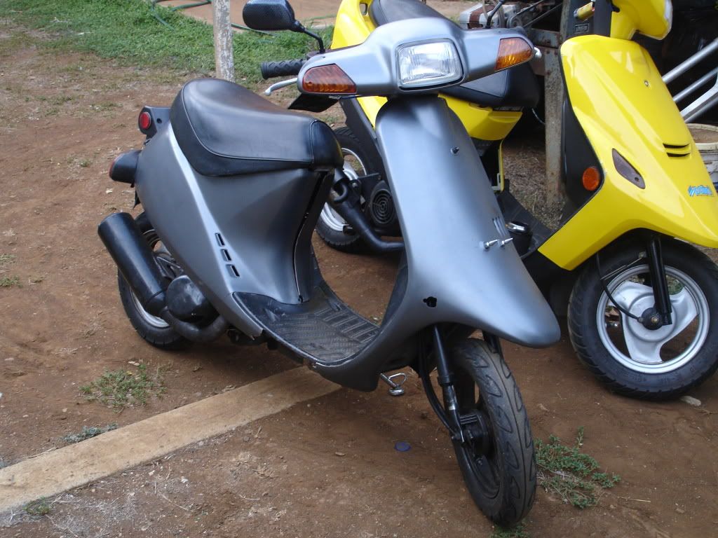

Oh, and this might help...
Honda SB50
Honda SA50
Dont look at the motors and whatnot, just the over all body style.
Elite Sr = Tail pipe is slightly smaller, but the trans does not have that plate.
The sticker under the middle of the floor bored on the left side. It has the vin and all the info. If it is an elite SB50 in not 100% sure on how the motor will fit in. A spree motor is the same as SB50. I know the shock is like a spree, and when people put 88-93 motors on spree (a common swap for people who cant find a dio) they have to put a odd piece of pipe, but you can avoid welding.
If it is a SB50, those have super light frames, so speed will be cheaper.
Honda SB50
Honda SA50
