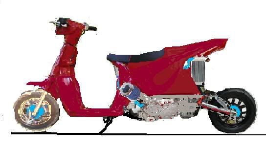

Water cooled 2 stroke kart motor(gotta fit under the panels and keep cool so a free air is out of the question) on a custom swing arm, single speed chain drive.

could it be done with a dual varitor kinda like a stage 2 clutch uses two plates to achieve a higher stall and better friction idk if this is possible but hey never know;; that has a centrifical clutch should hold up, and with the custom swingarm leaves the possibillity of a wider rear tire for stability
The wildest engine I saw was a YZ80 (or some such off-road 2-stroke) mated up to a CNC custom variator/clutch/rear wheel assembly. They removed the donor engine gearbox to do this. Should've put it in Adv Tech Docs... not sure where the pic is now.
Mopeds are easier to mod, they have swingarms like "normal" motorcycles so you can bolt in anything, run a chain, and you're done. Scooter require a custom swingarm/wheel assembly... PIA. A kart motor would require something like this.
A good start for a 4-stroke custom would be a Spree with a GY6 125 or 150cc air cooled motor from a Chinese scoot picked up cheap/free for parts. Problem is this won't be as fast as the wilder 2-stroke customs. I think it could be cheaper route to speed, though.

KT100 would need mods for water cooling. I really dont see the need for a CVT, these engines propel a (much heavier) kart to a good 80mph with a cent clutch.scooterwerx wrote:the honda ruckus has a modular transmission, meaning it is separate from the crankcase halves, a simple adapter would mate almost any kart engine(kt100!!!) to it...and presto, a real racing motor with CVT!!!
I was thinking of keeping the stock wheelbase too, it should all hide under the panels.
