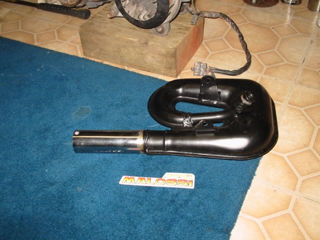

The pipes are not real common but can still be found. Most common are the Malossi Wild Lion's like this one:
The bores can still be bought new.
Thanks, nice pic. I'll go off and search for them.
