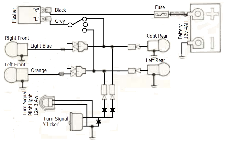

Hi,
Clivester will have great info on the diodes :thumbwink:
The 3.4w pilot bulb depends upon a much larger wattage turn signal bulb on the 'ground' side to light the pilot - yet *not* light the unintended signal lamp. In the OEM circuit, the pilot at 3.4w is small compared to the 23watt signal bulb - and there are 2 of them... LED's are so much lower current draw + the forward voltage is such they won't let much voltage develop across the pilot lamp. Instead - the unintended side lights up. I've verified that finding.
This is timely because I've been working on an LED conversion for the Gyro. It has been tested and is functional. Electrically the Gyro is similar to the early Spree. The latest model Spree (1987) no longer used the 'clicker' *and* uses a 3 pin flasher - so only the turn signal pilot lamp needs isolation. But if you have an early model, look for the 'clicker' on the wiring diagram and break it out to place into the path of the diodes. The clicker will also cause an unintended energizing of the other set of LEDs.
The third diode from ground to the other end of the 'clicker' can be left out if you have no clicker or are using the stock pilot lamp. It's to protect an LED replacement for the pilot lamp from spikes when the 'clicker' is present...
1) Redrawn schematic of the components involved (BTW - Spree uses a smaller fuse...). The Pilot lamp and 'clicker' (if present) both provide a low impedance relative to the LED's path which causes the unintended turn signal side to light.
2) Mods to original wiring with diodes added to isolate the left/right turn signal channels from the turn signal lamp and 'clicker'. For diodes, I am using 1 amp 400v diodes, (1N4004) cost was 0.03 ea.... well then there was shipping. In reality - I got 100 diodes including shipping for 3.00. Ready to mod 33.3 scooters :).
