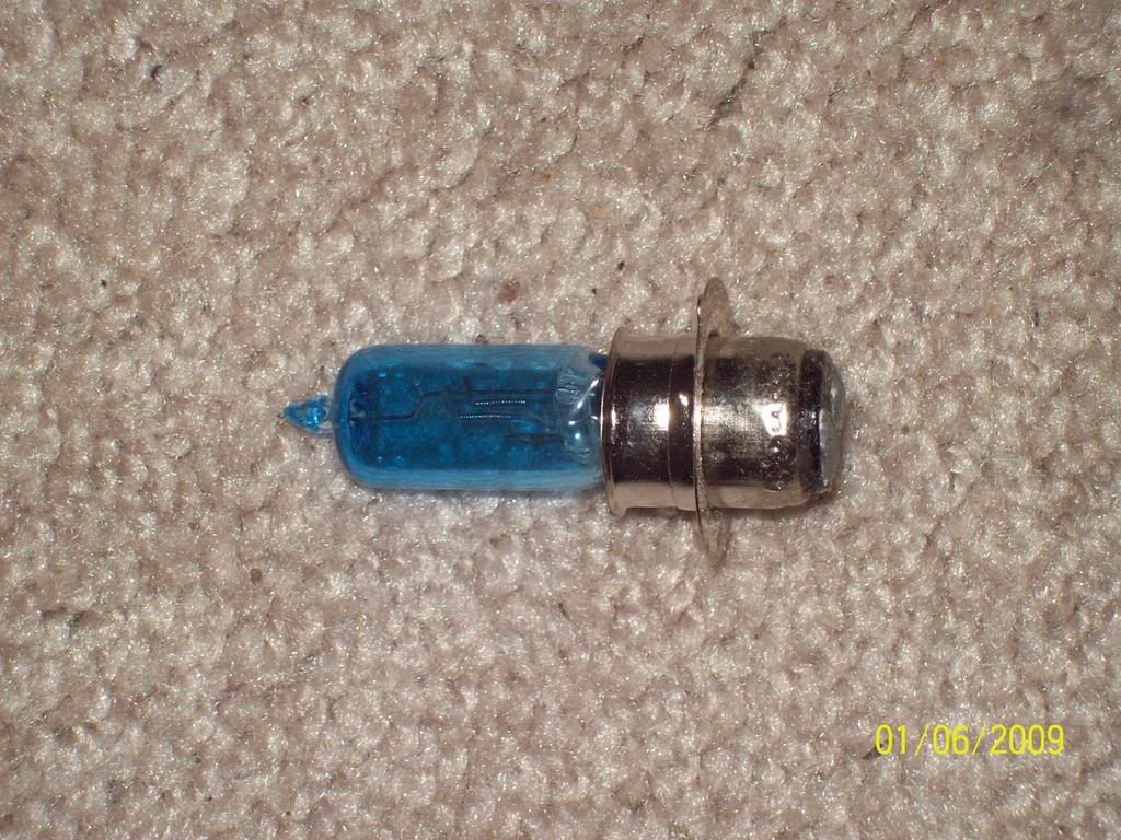

ALOW1 wrote:I had a burned out bulb laying around, so I cut it. It was more curiosity then anything. I know I can get a unit from an 01, but yet I am cheap and like projects. SO I wanted to know if it was possible to cut one and put a bulb in it.
Glass? Well, anyway. Some people are a glutton for punishment.
Yes, the bulb is glass.
However where you cut the plug off of the end of the bulb, that part is metal. Wrap the light up nice and good in a towel with just the plug sticking out, take a hacksaw and just cut it right off.
Wear gloves and a pair of safety glasses if anybody else decides to do the same.
I do not suggest that just anybody grabs a light bulb and just goes and cuts it open, put some thought into it and make sure you are safe in case something does go wrong. I have a pretty decent mechanical aptitude, with a degree in Industrial Engineering/Mechanical Machining.
808BMW wrote:I have a real H4 housing from a newer elite. The bulb plugs in fine. It would be pretty hard to get a good mounting service out of a non-H4 housing.
I agree with this, I was going to see about maybe putting the bulb in and just using some good ole JB Weld to hold it in there. I was just interested in a blue tinted light as you have with your newer composite style light. And if the bulb burned out down the road, I would just chuck it in the garbage as it was a junk bulb to begin with when i cut mine.
Yeah, the blue look is cool. I'm pretty sure I have a higher wattage bulb so it gets kinda hot, but the high beam filament is burnt out so I just keep my switch on high, which turns the headlight off.
I have a new bulb on order from jiangwayne (d*** you long shipping) and I'll compare them to each other. This was one of the first mods I did (back in 2004) to my bike so I forget where I got the housing/light.
Allow1 wrote:I had a burned out bulb laying around, so I cut it. It was more curiosity then anything. I know I can get a unit from an 01, but yet I am cheap and like projects. SO I wanted to know if it was possible to cut one and put a bulb in it.
Yes - you can make that work, there are folks that *have* to do this operation. Some 6v scooters with non-available replacements have been breaking out the back of the bulb, and replacing with a halogen. Its still a good project when doing is more fun than buying.

does your bulb look like this.

does your bulb look like this?
I haven't pulled the JDM bulb, so can't say, but it doesn't look like the 2001 Elite headlight at all. It is built on a 90 and has three prongs instead of two contact points. The taillight looks like an 1157 automotive bulb.
the tail light is a 1157 but for your JDM dio sr the headlight might be the one pictured.
