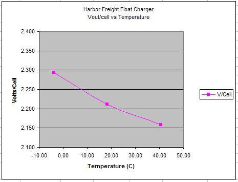

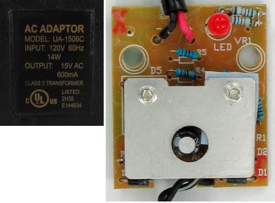

That 5amp low end rating caused some head scratching. The rating of the 'wall wart' and the regulated voltage is within the wet cell batteries we use in our scooters. The wall wart is rated for 600mA, which is ok for our batteries and 13.2 is within recommendations for wet cells in float charge usage.
Pic below shows the wall wart, as well circuit board inside the 'blob' in the middle of the cable. Its the regulator section, and I've tested it for temperature compensation. For good life under float conditions, the charger *must* be temperature compensated. If not, and the battery maintained is not at room temperature, there will be either undercharge or overcharge. Happily this charger is, and the curve matched up with some vendor battery technical data.
Readers - There are more sophisticated battery maintainers such as the 'Battery Tender Jr". If you like the best. buy one, it will coddle your battery. But thus far, battery life(4+yrs) vs cost of this charger has been good.

The charger will do a better job if the batteries are closer to room temp. Temperature compensation of the charger helps, but at either end of the temperature range there's other problems. High temperatures accelerate death of the battery with or without a maintainer. At low temps it won't accept the maintenance charge well.
