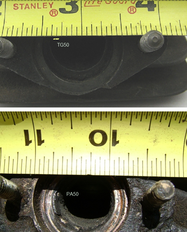

One thing I've wanted to see is an exhaust port comparison between the PA50 and TG50. I found a PA50 cyl measurement on the 'net, and scaled a TG50 to match. Gyro's are a little smaller stud to stud, but it does not look to be a show stopper.

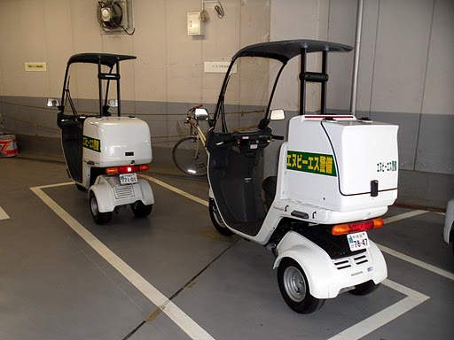

A friend of mine went to Japan for a vacation 5/20/11 and sent these pics to me ...
Mine look great next to these I was going to ask him to bring back a shop manual but then remembered I don't read Japanese ,so it would probably be of no use to me .
Re: Gyro - general thread
I think he sent these to * me off as he knows how much I want a canopy model . I need one of these w/ air conditioning ...
