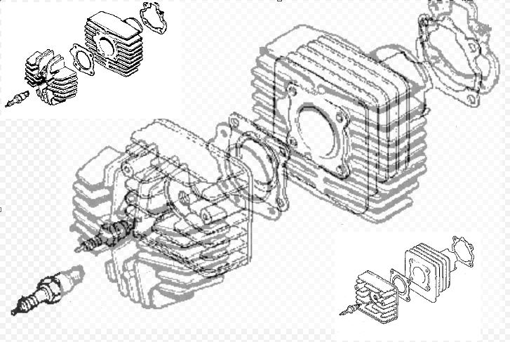

Does anyone have the ability to compare cylinder from Honda Hobbit to the cylinder from Honda TG50 Gyro S ??...........reason for asking----there's bucket loads of Hobbit stuff out there and surely something will cross over to the gyro......I gotta know..........thanx..... :urban:

  • IRC there is a stud center difference between the two jugs. 'ped boards have topics on PA50 vs AF05(Elite/Aero) kits. Gyro and AF05 have the same spacing.
  • Radial vs axial cooling fins are a big difference, but the PA50 had no cooling fan. Bored out I wonder if there's enough air flow on the rear facing cyl?
  • Stroke difference, PA50: 39.5mm, TG50: 37.4
Given the skills and drive of members - it may be someone can get one going.:. Parts fiche pic below give a very rough comparison.

Thanx a bunch for sharing your com-skill and enlightening me. Your time spent is appreciated. My curiosity to point in question is quite satisfied. If ever the time comes to tear down the Gyro, this info will help steer me another direction................mousewheels :rock:

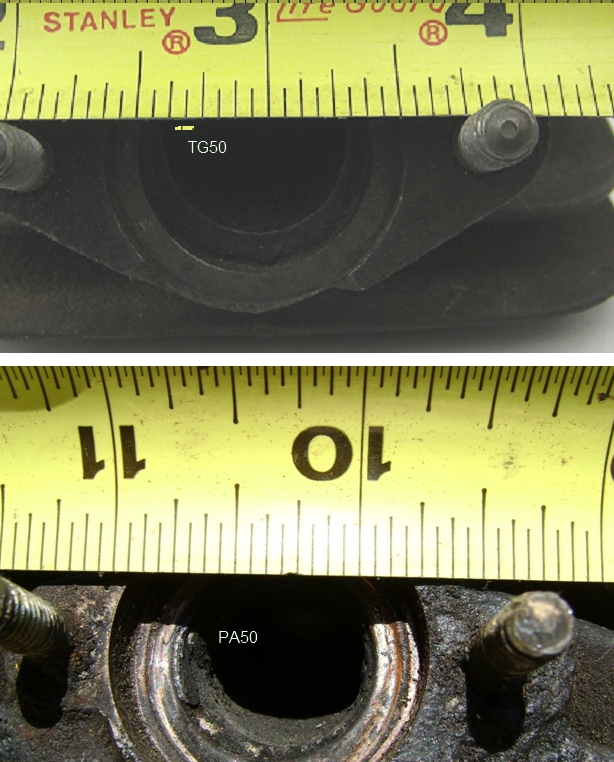

One thing I've wanted to see is an exhaust port comparison between the PA50 and TG50. I found a PA50 cyl measurement on the 'net, and scaled a TG50 to match. Gyro's are a little smaller stud to stud, but it does not look to be a show stopper.
