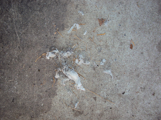

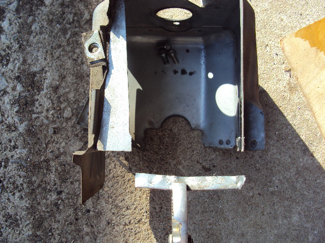

THIS IS WHAT HAPPENED LAST TIME*************************

...that rattle turns out to be an exhaust shield on the pipe that had broken out around the mounting screw. Five bucks and five minutes with the oxy/acetylene torch and I had a washer brazed in to fill the missing piece. The loose wheel was only a loose axle nut. Mounted last with an electric impact, I must have been a little stingy with the trigger. Caught this early, otherwise would have resulted in some axle/wheel damage. Torqued it this time with 55-60 lbs.Test ride of 60 miles proved to be all good...until....zing went the belt. Now I'm back to scrounging around for something to get Ruby back in the groove. Times are tough.... :hi:
