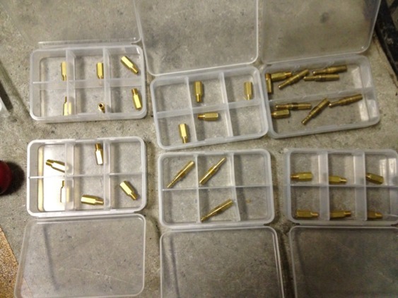

the pilot jetting and main jet start off 52-150 . then work out down size jet.. 32:1 premix.
because the boost port you made it bigger.

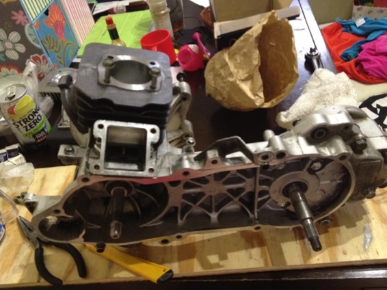

Got the whole engine reassembled today I'm tired and it's late, done about 30 hours work into this build so far!!

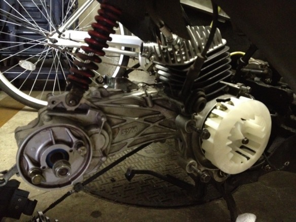

Got the bike back together today, will go and get a new spark plug and jets later then I'll try to start it!!

:bowrofl: :bowrofl: nice very nice :bowrofl: :bowrofl: that new fan looks real good :peace:

Time to jet!!
