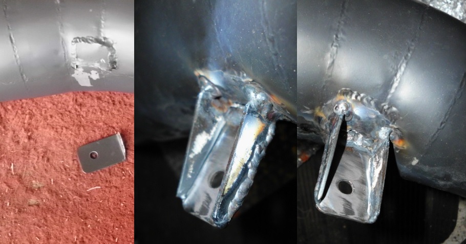

Picture below
felt a weird vibration about 15 miles from home
got home and found??
with only about 500 miles on the pipe and it broke :sad:
the bracket that holds the muffler part on
broke off right at the bend on the pipe
vibration found

fixed It added gussets to side of bracket
thought I should have done this from the start
broken fixed.jpg (123.44 KiB) Viewed 7838 times

nice work .Ive had to reinforce the mount points on my scorpion pipe .Our bumpy earthquake damaged roads dont help and ive had a little bit of air going too fast when hitting some of the humps in the road lol

Wow cruz.
I hate when that happens.
nice repair. :thumbwink:

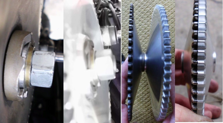

phongeer drive face
do you gain any max rpms =no
does it rev a little faster = yes
problem
the kick starter face is .050 less than the stock face
that combined with the malossi crank which is longer ( for the zx trans which I am not using)
the kick starter dosent work
solution
the polini variator comes with a longer app 1/8 in variator drive boss
if you put it in the belt slips at take off but if you shorten it
I found .080 longer than stock was to long and at .060 my belt didn't slip
and the belt was down further and took off better
so does anyone know where I can buy a variator shim kit
so I can add and remove shims
more to come

Re: 2000 Mystic Purple Elite build (70.1 mph)
Bigger hardware stores and your favorite Bolt and Screw store in The Bad Part of Town carry 14mm washers for every occasion. I've even used discarded spark plug washers. they crush down to about 1mm thick. I now have a collection of these, as Home Depot's might be thicker than Lowe's for example. Just make sure they're no thicker at the Outer Diameter than the drive boss, or mount them behind.

Thanks cruz for posting this info.
I may order one for the faster revs.
thanks WM for the shim info.

put the pg short on again about 3 weeks ago
constructon zones are not your friend
leaned into a turn in a construction zone hit a bump and push the muffler part into the chamber
cracked the strap that holds the muffler and cracked the pipe
at the muffler mount next to black line
back to the welder
