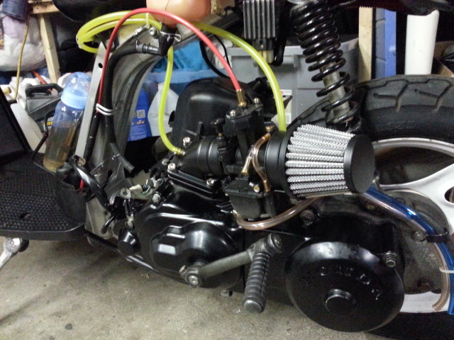

I plasti dip the carb. it's the rubber spray in a can. you can peel it off with a toothpick.

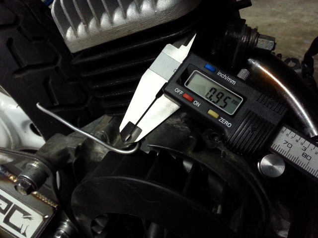

I did a squish clearance test and came up with 0.95mm. I should be around 0.6-0.8mm.

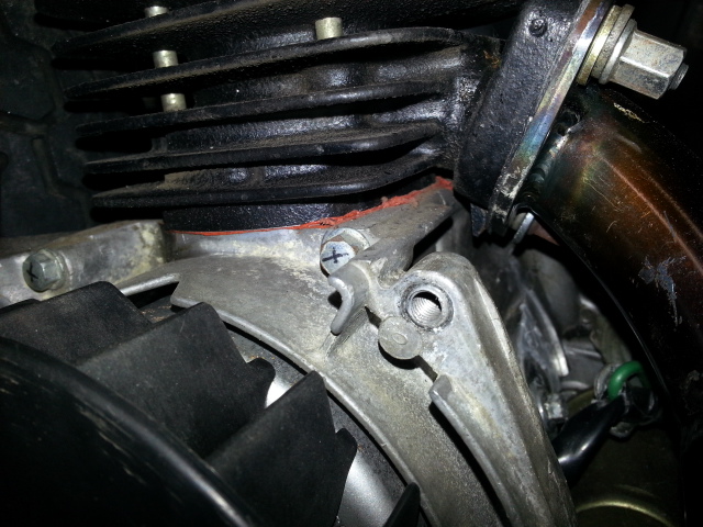

I think i found the problem for the low psi on head. I use rtv silicone to seal and, cover some of the scratches on the cases. the silicone may have lifted the head a few mm.
Update: the compression tester was no good. a very thin layer of silicone on base gasket is ok for sealing.

hi graphite. I have to get a pressure tester to check the gaskets. I don't see or hear any leaks. Everything is dry.graphite9 wrote:Yeah I wouldn't have used that on the case. I sometimes use a super thin layer of hondabond. did you find a leak there?
thanks. all help is appreciated.
