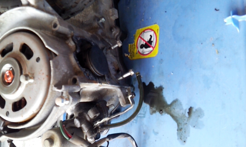

Popped muffler off, exhaust port dripping. Fml, still flooded...I'm going to have to tear down this whole engine. Great.

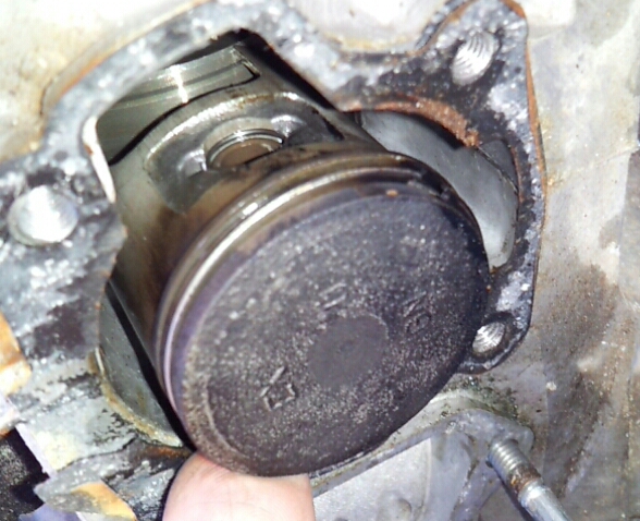

Took it apart. And yes, gaskets are shot. Oily/watery fluid was in crank. Is this sufficient to dry out or pull engine in halfs? Piston & rings look ok.
