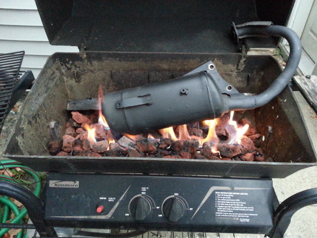

Took a torch to the exhaust to try to burn it out and after 20 mins I let it cool and took it for a spin. Seems to run a bit better but I'm sure a good fire would really help it out. Temps never got passed 320 and It sounded better. Not sure if the initial burn out helped but it's definitely better than it was. gonna ride it home and see how it goes. If i get time tonight I will get a fire going and burn it out.

Thanks but ran great home different sound coming out of the pipe. Think the first burn did most of the work. Got it up to 340 with no fire coming out the pipe. Need to do some tuning now. Running a 102 main and not sure if it needs more fuel or air right now. After 1/2 throttle I gets a really deep howl out of the carbs but doesn't really do much. Seems to run best at around 1/2 throttle to get up to speed.

Hi RCS. I give it about an hour. Or until it doesn't smoke anymore. Lol
- 20141029_170043.jpg (181.63 KiB) Viewed 6855 times

Seems like I read something about bringing your pipe to a radiator shop and having them dip it in some sort of tank. Ive never had a pipe long enough to accumulate any build up

This one is an old one g9 had around so not sure how many miles it has on it. There were a couple old bbqs at work maybe I'll get one going at some point. Kinda busy this week haven't been able to do much. Just hoping to ride it into town this weekend for "the one motorcycle" show. A great custom motorcycle show in town.
