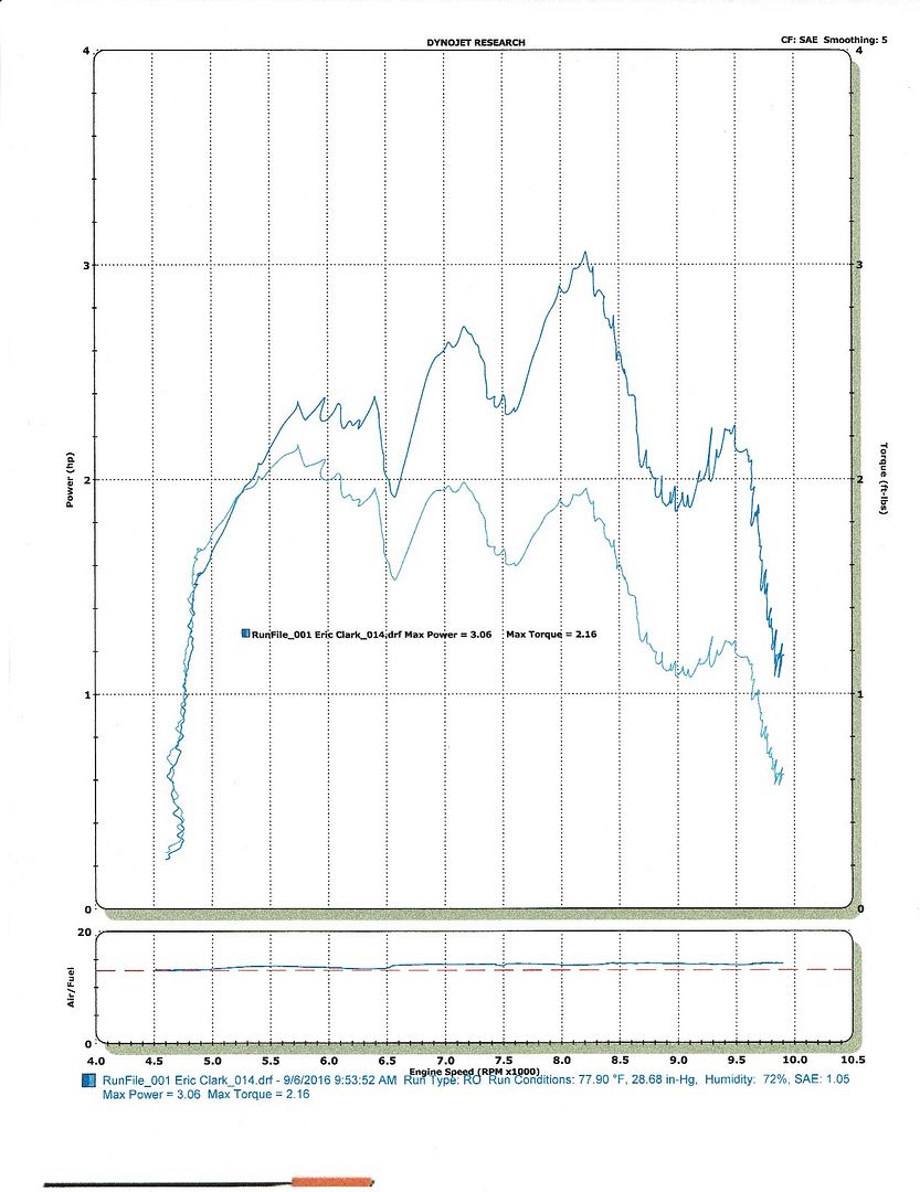

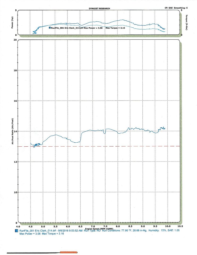

Well, just got done with the next set of runs, and.... WE HIT 40!!!!
I have the videos uploading right now and will post them as they get published on YouTube.
I tried out my 128:1 in the tank theory, seems like I was right on the mark.
What we have concluded on this set of tests is this:
YES, we more then likely do need not only a larger main, but a larger pilot as well.
The lubrication was perfect this time, no excessive smoking, no saturation after I gave it a 128:1 adjustment in the tank.
Tests were again run pretty much the same way as last time. Air box lid on, filter in, then lid off filter in. Then we did hole 1, then 2, then a 3rd. After we collected all the data from those runs, we did a bump up in the oil so we could test higher RPM ranges.. will get to all that in a bit, but for now, while I'm waiting for videos to upload, I'll post this..
These are printouts from the best run
eclark5483
Posts: 1261
Location: Spencer Iowa
Re: Getting the Tazland BBK, GEARS, + MLM ran on a dyno
Post by eclark5483 »
OK guys, here is the dyno run that corresponds to the graphs I just posted.
This was the best run with the Spree giving everything it had to give (for now).
It was ran with 128:1 in the tank, Dyno fans on to keep it running cool just in case... NO AIRBOX LID, NO FILTER. This was a free air run.
I'm gonna be a bit busy here, so I might not get the other videos uploaded till later today. I urge people to not only watch the video, but listen to the conversation Shawn and I have about what has been happening.. Enjoy :thumbsup:
