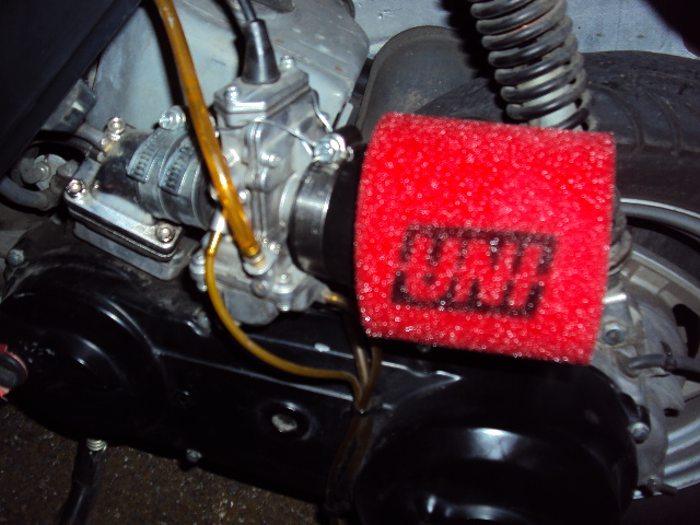

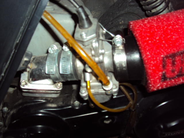

About a week ago, I came out of the deli and jumped on Ruby.
Turned the key, hit the button, and the racket coming from the left side was startling. WAP, WAP, WAP....
looking down to find the carb "dangling" from the hoses... :surprise: :surprise: :surprise: ... :*:
....PROBABLY an accident by an unconscious hipster texting his latest status on fb,
OR was it a maliscious foot involved in the dislodging of the firmly secured Mikuni... :?: :lol: .
....either way, the K&N pod filter suffered damage of the crumpling kind.
So, today i slammed the UNI on for a 30 mile romp up to the Smokin' Pig BBQ.
Oiled and safety-wired to the clamp, the difference was negligible.
I expected a louder report...didn't happen.. :smile:
Mine has the slight angle. Cover still not likely to clear, haven't tried yet... :hi:
