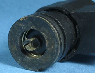

I have, already, received my bystarter.
They are VERY much look alikes.
I measured the needle and piston and they have the same size, profils look the same and the distances between bottom of the plastic part and the base of needle/piston are the same.
The noticable differences are :
Overall height is taller on replacement part and the plug is different.
Pictures (the OEM one is the one with grease on the oring) :
I had already noticed that my pistons base seems to be missing a sort of rubber gasket (the black part that you can see VS brass on the OEM part). Maybe that's why the bystarter couldn't shut off completely when hot.
Where could this rubber thingy have gone???

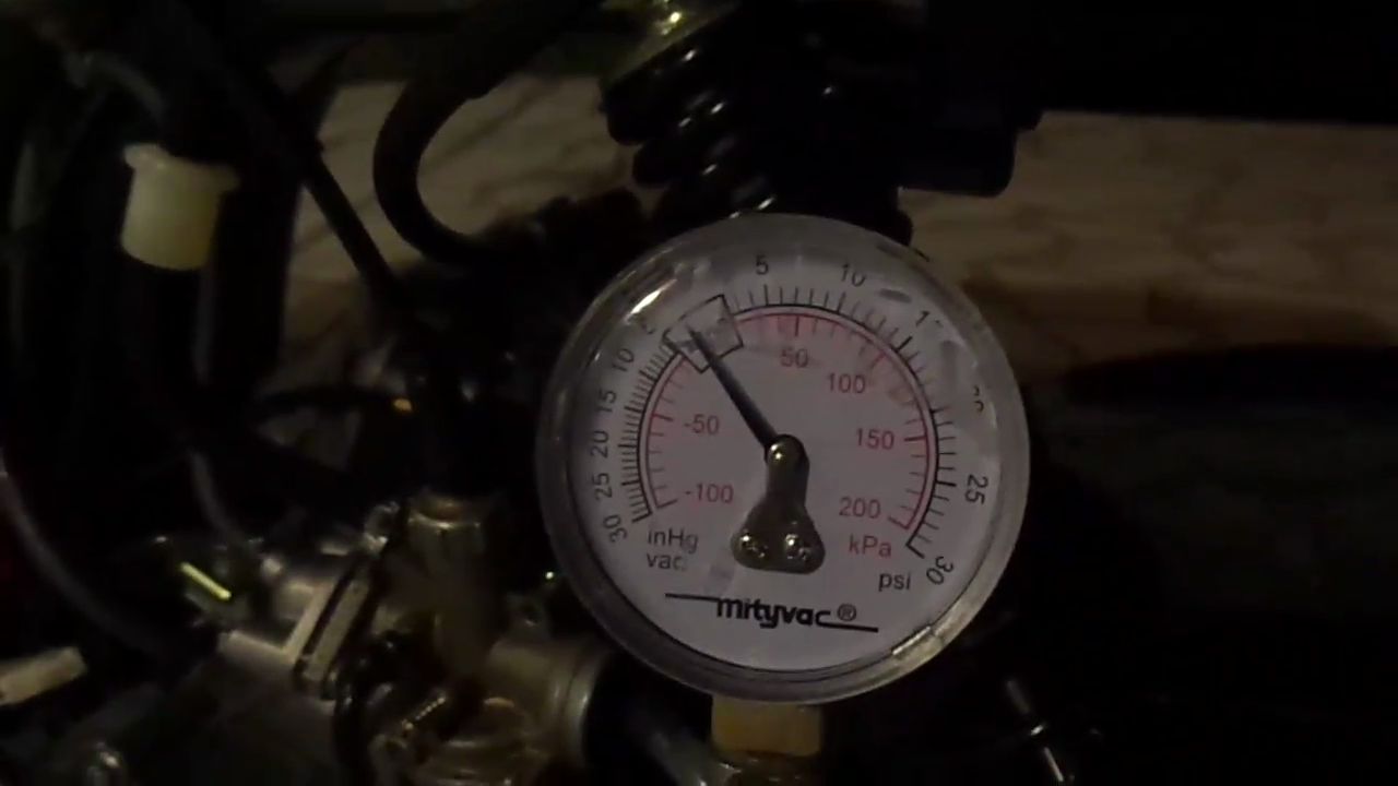

So, I did a test after putting in the new bystarter.
The pressure test when hot is better. It almost keeps the pressure, that is to say the pressure slowly goes down and not freely as before.
BUT, the darn thing still won't idle when hot! It slowly stalls as the engine heats up.

OEM bystarter has no rubber seal at tip
Clone rubber seal may limit travel of the bystarter to the point the air valve will not fully close
I don't know if the rubber seal is the issue with your carb, but two of your points make me think there is too much air passing through the bystarter circuit when it's extended

The reference for the bystarter
As you can see above, the replacement bystarter looks very much like the OEM one.
Except for the rubber seal.
I measured things and had a close look at the needle.
I replaced the red connector of the replacement part by the OEM bullet connectors by cutting some wire and soldering it to the new ones.
I cut the old wires keeping a bit of advance in case I have to change the bystarter again.
Some tubing that retracts with a heater to protect my solders
Rubber seal out
Testing the carb
This could be considered as an acceptable air leak on a working bystarter (it works well on mine) :
Sweet start and idling (at hot)
